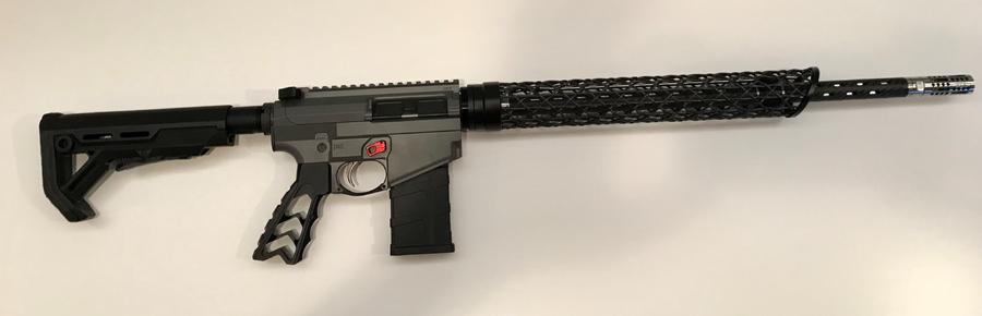

Yes the screw is too small for the reciever...which leads me to believe the hole was drilled too large. Sloppy tolerances. So now i have a complete rifle that literally wont stay together, even tried another one of these screws still loose. So now i have to track down a screw thatll fit, lucky me, worst $1000 i ever spent.

Just a small update, i just took the screw out completely to see why it keeps coming loose, oh wow its THE WRONG SIZE GOD DAMNED SCREW. good job maccabee, ive given you the benefit of the doubt too many times but now this is the last straw, you guys have no business operating machinery.
Probably no helicoil installed
Correct as I had a few delivered with them missing. I purchased the correct size helicoils and installed them without issue.
If posters need them installed they can PM me.
Note: the grip screw is identical however the bolt is shorter then the grip bolt.
