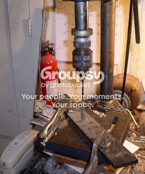

So I need to drill a hole through the stock (press fit) and lug to hold it together....that would explain why there are pins left over. This is going to be a challenge getting the holes lined up.:eek:
Thanks for the link Steppenwolf...very useful info there. This picture from the tutorial will save me a lot of grief trying to line up the holes between the barrel and trigger assembly.
From Mike Brooks Tutorial:
