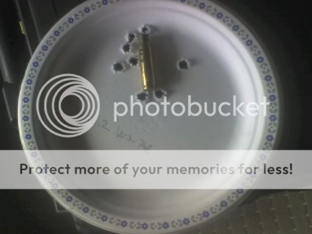

was testing different loads lately. 150grainer boat-tailed hornady bullets over WIN748 and CCI primers. 46.2grains of charge seem the only one accurate and reliable in my M14. I tried 45.7, 46.2, 46.7, 47.3, 48.5 grains of charge so far with spotty results for all except 46.2. Overall I am happy with rifle, set up and ammunition, ready for spring blackies season. Below is 8-hole target shot at 100 yards. I know it doesn't look like much but keep in mind this is red dot optics which are generally not a very accurate aiming device.

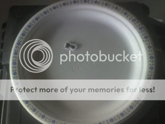

...and sighters shot at 50 yards
all 10 shots are on paper :). Kevin - thanx for the rifle, it will serve humanity for a few years
