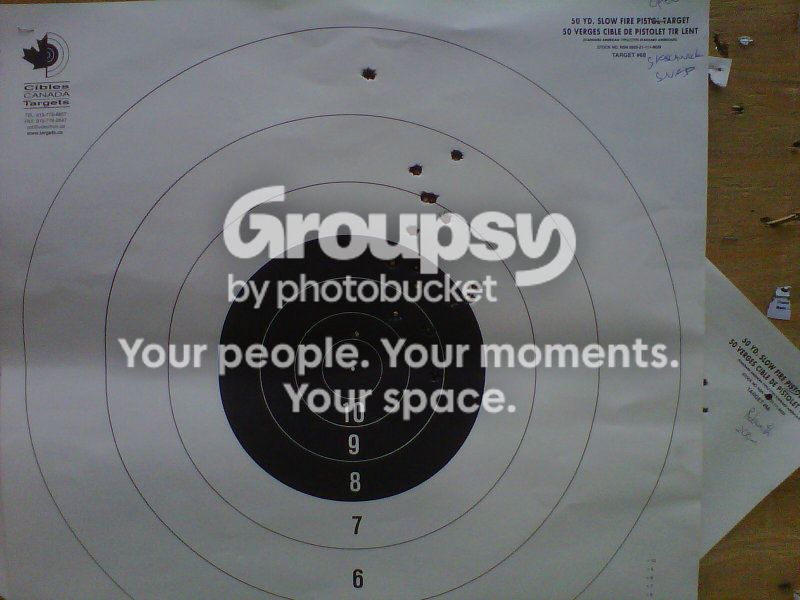

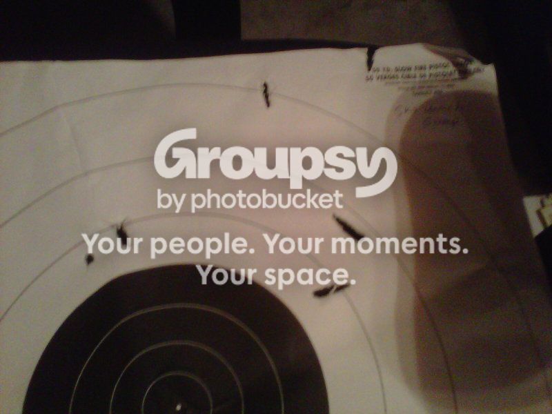

Anyhow, here is a photo of my "snap" stage at 100 yards, (hence the 2'x2' group!). The big thing to note is the 5 obvious keyholes using 0.3105 bullets.
I shot this today, 17 rapid shots from the bench (I signed in at 12:35 and out at 13:00 and that includes putting up target, checking it twice, removing targets and packing up).
The idea of today's shoot was to see if I could get a keyhole with 0.312 bullets. No keyholes. Group seems okay as well, but I should move my front sight a blade width to the right and drop the rear down a bit. Anyhow, I think I am moving to 0.312 bullets.
