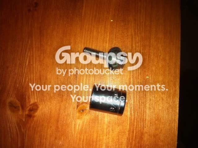

Well, I didn't have time to make it to the store for a new pin and an extractor but I had time before supper to try out tiriaq's suggestion. If I had known how quick and painless this was last night I never would have reached for the hammer. But then again, I never would have thought a case could be wedged so tightly in the die.

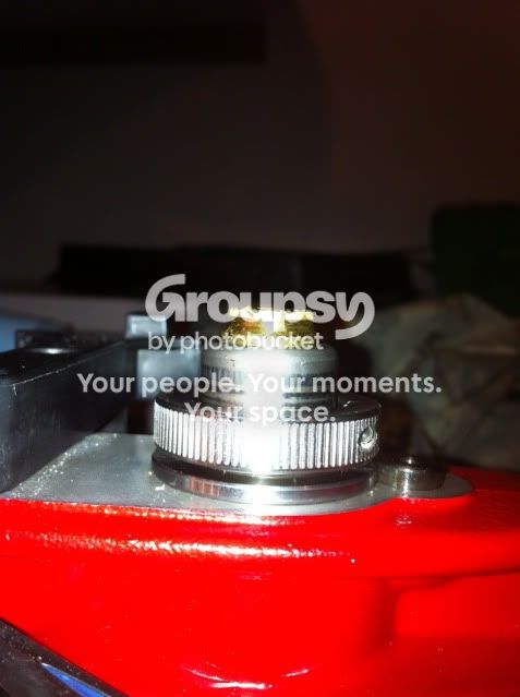

Here's what the ripped off rim looked like:

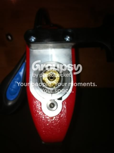

I set the die in upside down in a Lock Ring Eliminator Bushing in my Lee press, and locked down the bushing. The press just acted as a holder or "third hand" and wasn't actually used to pull or press anything in this excercise.

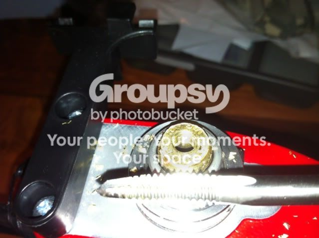

Using the flash hole as the pilot hole, I drilled a 13/64" hole through the base. I then tapped it to 1/4" x 20NC.

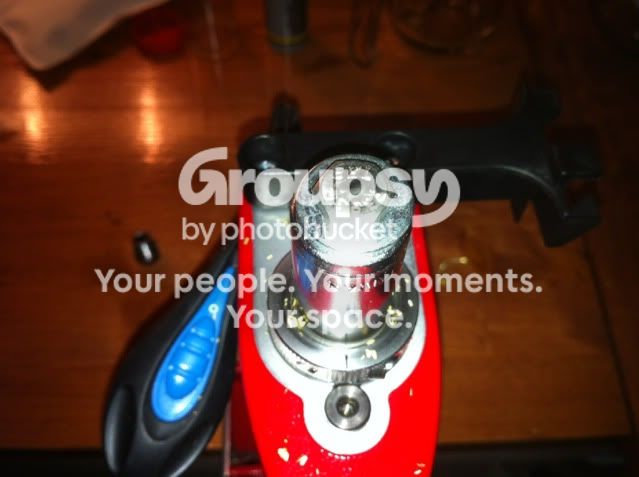

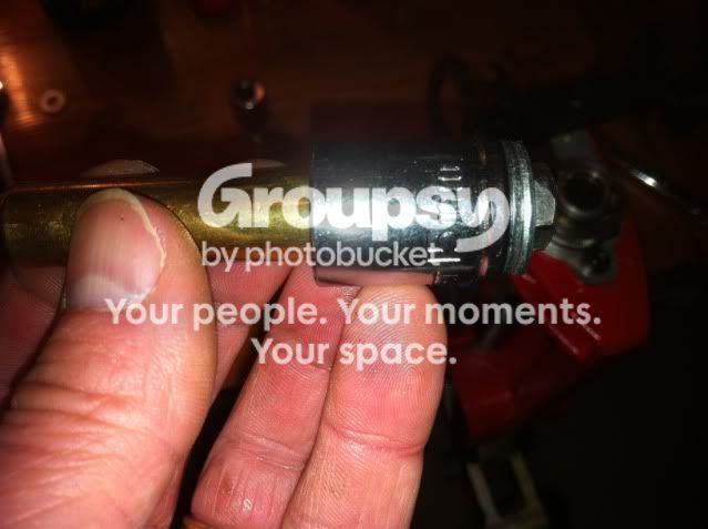

The extraction kit: A 1/4" bolt, a washer or 2, and a bushing. A socket works fine for the bushing.
Put the bolt through the washer ( I found 2 washers worked better), then through the bushing or socket, and thread it into the hole in the base of the case I had just tapped. I started out with 9/16" socket and it seemed to be the perfect size but then the 300WM case seemed to catch it as it started coming out. A 15mm socket worked perfectly in this case. You just need to make sure the bushing matches up with the base of the die and doesn't interfere with the case being extracted.
Even though the die was locked down, torquing on the "extractor" bolt was spinning the die in the press. The Lee FL dies have a couple of cuts so that a 3/4" wrench can be used to hold the die when torquing the pin collet down. I used the 3/4" wrench to hold the die in place as I cranked on the 7/16" bolt head. Other dies may not have this feature.
Voila!

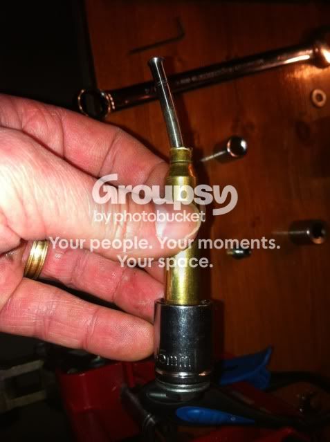

As you can see, the pin is toast and the inside of the die has some light damage from also trying to punch the mouth of the case out from the top. Some brass punches might have prevented that and they're now on my Princess Auto shopping list.
Thanks everyone. I appreciate the help and advice! Although I may have ruined a die, I learned from my mistakes and re-learned an old trick (tap, bolt and bushing trick) and I got some great info from you guys.
