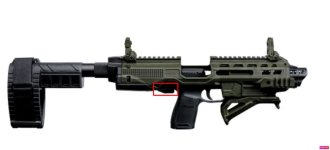

My kit has just arrived (not even out of the box yet), I got the brace as it looks light and nimble but I got to thinking I am more used to buffer tube stocks so I might pick up one of those (looks like it is different to an AR15 type tube as per the description):

It should take a standard tube, then you can put whatever stock you want on it.

Damn I hope you are right. The skinny brace looks cool but it doesn't feel natural at all and I can't get any consistency when I shoulder it like I would when using a AR15 type buffer tube and stock.
Will experiment later..... Thanks!

You were both bang on, the brace is threaded into a female threaded buffer socket type deal. There is a little screw that goes up into the groove in male threaded part, once it is removed the brace can be screwed out (was only hand tight).
I then installed a buffer tube from an FX9, it was kinda tight but it went in without tools. The socket is pretty shallow so there were a good few threads not engaged but I tightened the castle nut and it all seemed solid.
It feels better with the buffer tube and stock, certainly much more like what I am used to. It *might* be too short for me even fully extended but I will try it first before making that call.
I still think I will need to "adjust" the locking piece that holds the gun at the rear. It is kinda cumbersome and gets in the way but all in all now that I have the stock fitted and a dot mounted it is starting to take shape.
