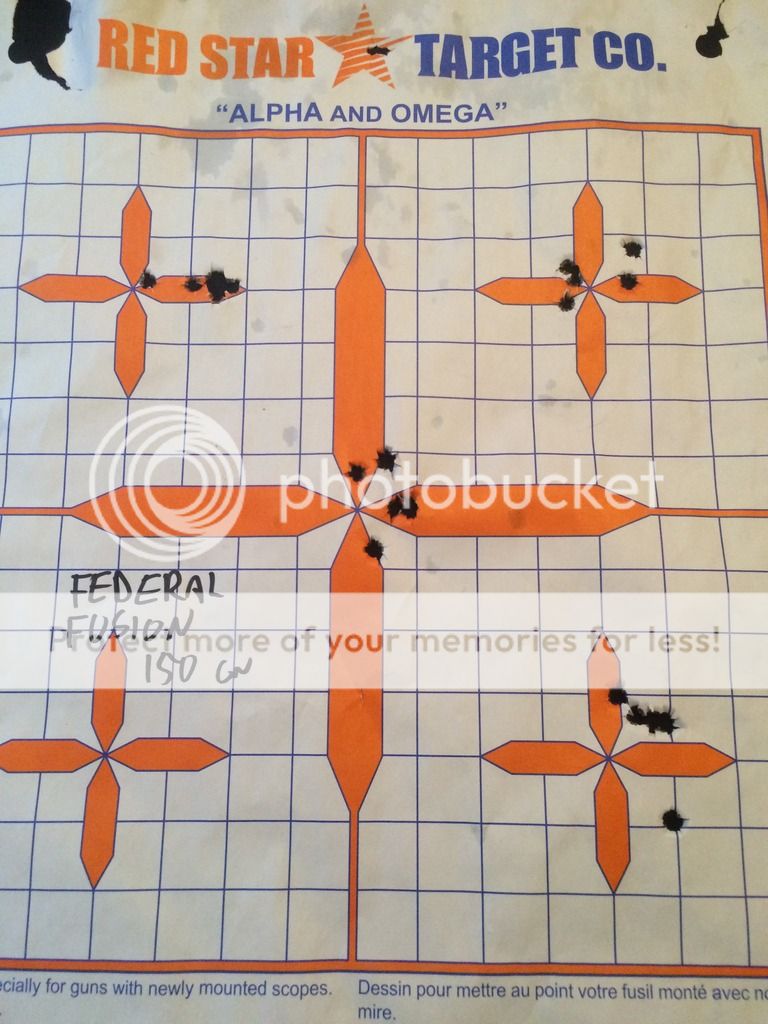

I tried a few different holds, some with my off hand on top of the scope, some with it under the fore stock, some not touching the fore stock and grabbing the rear bag. The hand on top of the scope is the steadiest by far, but doesn't help the groups any.
The trigger is very nice, probably somewhere around 3.5 - 4 lbs. I will adjust it down to 3 lbs or so. I think I will have to bed it as well. I really don't think it's me, as I had my Sako 30-06 out again today, and it's shooting 3\4 inch with no problem at all.

The group at center of three is typical of my Kimbers, this is the Adirondack shot hastily off two stack rubbermaid containers from a computer chair, it's actually the very first group it shot, sighting in, it's an inch with the third stepped out from the initial tight pair. Still exceptional hunting rifle accuracy. The large group above was an off hand group for one of the forum "challenges", and I returned to fire a fifth shot at it hence the add on.
I posted this once recently and many disagreed, but my Adirondack definitely walks as it gets warm. The first two rounds touch or close, the next steps out, just the nature of a barrel that light and fine by me.

Looks like it's shooting similar to my Adirondack with the Fusion, any chance you know the order of how the rounds hit paper? Mine puts the first two touching, or barely apart, and they start stepping out from there even if a few mins are taken to shoot the group.

Looks like it's shooting similar to my Adirondack with the Fusion, any chance you know the order of how the rounds hit paper? Mine puts the first two touching, or barely apart, and they start stepping out from there even if a few mins are taken to shoot the group. It looks to me like yours likely acts the same. This was politely questioned when I posted it in another thread, but my Mountain Ascent does the same, the Talkeetna does not but it's a heavier barrel. Like you I have other rifles to shoot beside it with heavier barrels that don't act the same. I don't consider this a flaw at all, with the weight of the barrel makes sense and I'll gladly accept two to three tight rounds before it walks for the shaved pounds.
This was my blurb on it, and if I'm guessing right yours is doing the same thing.
