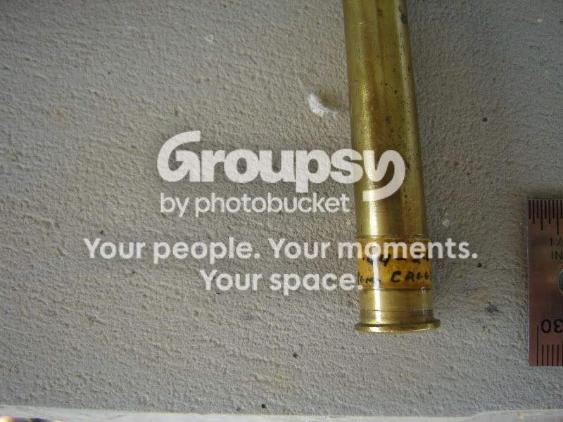

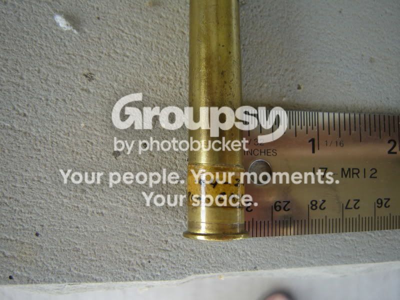

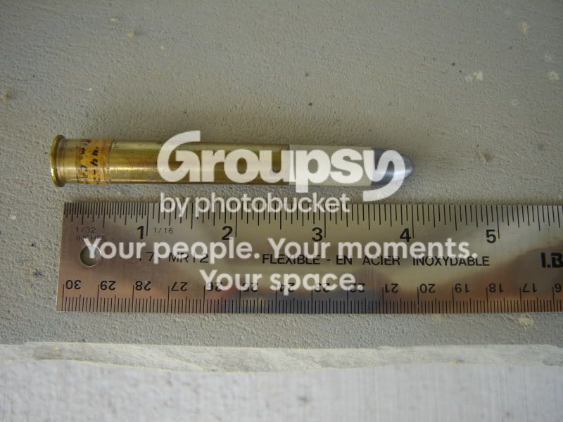

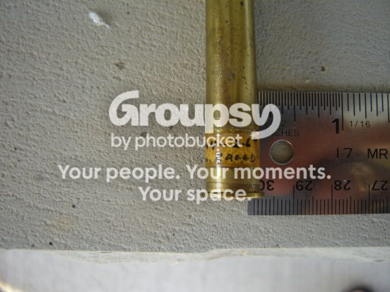

Here is what a .44 2 6/10" will look like . This one is for Remington Creedmoor
.44-90 also .44-100 Rem Straight
Bullet dia. .442, 470g. lead, powder 4198, 27.0g, vel. 1410fps.(source Barnes)
case lenght 2.60", head dia. .503", rim dia. .568, neck dia. .465, body angle .43 degrees, loaded lengh 3.97", rim thickness .070
