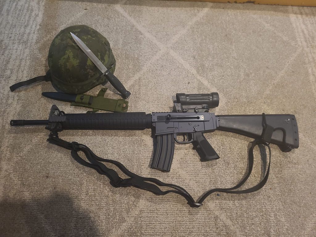

Sooo yes or no on the a2 handguards? “Likely not” or should it work with some effort since the original polymer a2 handguards were pretty tall, which would accommodate the gas system?
