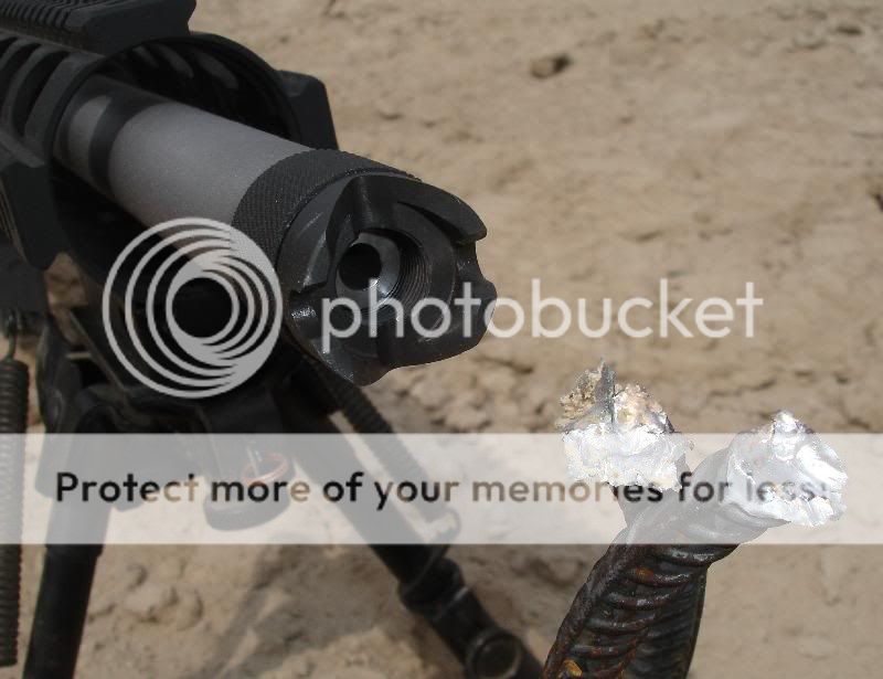

While this would not be completely Canadian made, how about this;
Take cheap Bulgarian Krink brake and weld on 1/2 28 thread adapter.
This is exactly how Noveske started out with his brakes. They are no longer listed on his site, but you'll notice that his old style krink says U.S made as he use to offer Bulgarian conversions and made in the good ol' U.S. of A new versions for those "only buy American" types.
If I'm not mistaken, someone in Canada might be doing this already. I think Valley Gunsmithing lists Krink brakes on their site.
The inside cone openning does not touch the barrel, some gas gets trapped in the space behind the cone which is inside the unit.
There really are only 4 pieces:
1. the Body itself (with the thread adapter welded on)
2. the cone
3. the cap that threads onto the body and keeps the cone in place
4. a coil that keeps the cap from unthreading itself
the coil makes it so you can easily remove the cap while having it very secure (will not unthread itself)
The cone has a lip in it's widest part and this seats it in the body, and then the cap holds it in place.
It works very well for reducing side shock waves
