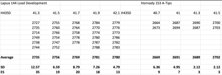

Going to shoot a ladder and chrono the string. So should get some good data hopefully.
So I went back to the range with 6 loads of different weights with the Lapua 144 Long Range Targets.
Lapua Virgin Brass (Small)
CCI 450 Primers
H4350 Powder
330 Yards
0.015-0.017 Off the LANDS
I think I am going with 41.7 and 42.0 to do a 10 shot group and that should be good.. Not 100% happy with these even though a couple charges shot 0.5 MOA as thats due to the fact I loaded a few rounds of the Hornady 153 A-TIPs and those shot crazy tight at end of session with hot barrell. I wasn't even doing accuracy just trying to get velocities.
Any advice on the above plan> 41.7 and 42.0
Factory 143 eldx does 2680 out of my 24" Howa . H4350 isn't a high velocity powder choice for the 6.5cm, most guys are using around 41.0grs with a 140 class bullet. Ive found generally that lower charge weights outshoot higher charges in a good amount of different rifles/cartridges/loads
