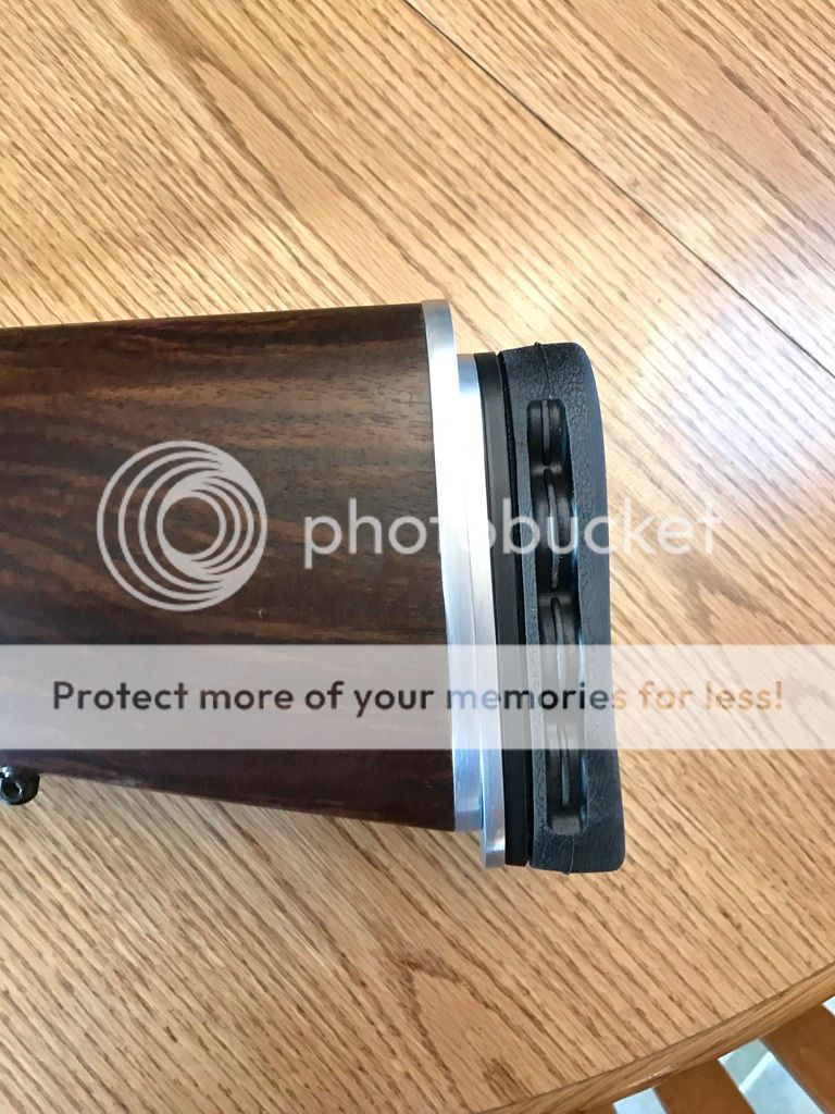

I started clay shooting a couple years ago. I bought an A400 to use as a duel purpose gun for hunting and clay busting. It never really fit me right so I ended up putting an adjustable butt plate on it to increase the drop by about an inch and increased the LOP by about 3/4" It now fits me well enough that it's not an issue. The gun however is very light and doesn't swing the best so now I'm looking for an O/U.
