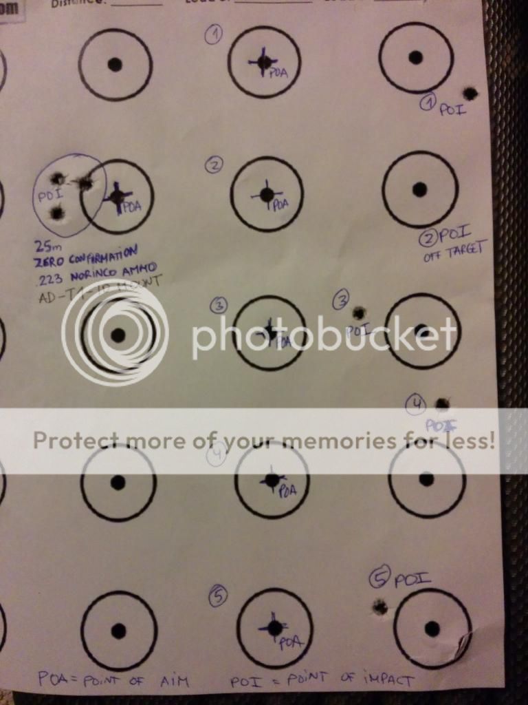

That is very intresting Reddot.
My AD-T1-10 mount doesn't. When I tested it I noticed point of impact change every time T1 was remounted.
My apologies was crappy picture!
Shoot 1,2,3,4,5 were taken after Aimpoint w Ad-T1-10 mount was remove and then put back on the rifle.
1) Point of Aim/Impact difference 2.178 inch
2) Point of Aim/Impact difference 3.253 inch
3) Point of Aim/Impact difference 1.335 inch
4) Point of Aim/Impact difference 2.699 inch
5) Point of Aim/Impact difference 1.537 inch
* This is not a scientific test just me playing with my kit - take it for what it's worth
TDC,
I don't believe Norinco ammo is to blame in this case. It grouped ok before I started mounting and un-mounting it. Another possibility is that there is something wrong with my ADM mount specifically. Have you tested this and got different results?

Try shooting groups and using a quality brand of ammo..
