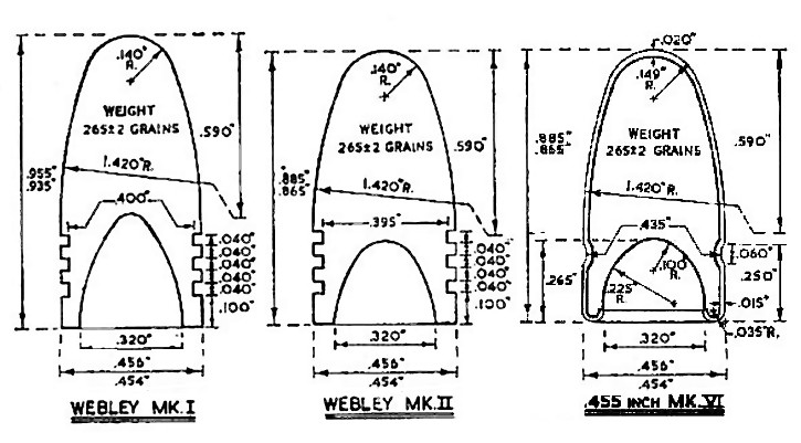

Hello, I'm planning to start loading some black powder rounds for a Webley Mk1. I have some bullets .455" in diameter, which is .007" larger than the groove diameter in my barrel. I'm guessing that unlike jacketed bullets with smokeless powder (for which I have been advised to stay within .002" larger than groove diameter), soft lead bullets with black powder can be a bit larger. But is there a limit to how much larger I can safely go? I feel a bit suspicious about forcing a .455" bullet down a .448" bore, even if that is what the Webley was designed for.
I can’t give you an exact number but you do want to be at least a couple thousand over with lead, if not you stand a good chance of leading the barrel.The bullet has to be tight enough that the gasses stays behind the bullet and doesn’t push past it and cause leading. Use a good lube or powder coat! Did you slug the barrel to get the groove diameter? Not every barrel conforms to published specs.
If the cartridge fits in the cylinder the bullet will go down the barrel the throat of the cylinder will size the lead as it goes through.
My Uberti Highwall slugs at .457 and my 393 grain NOE mold drops at .4605. I shoot them as cast without sizing and have no issues. They are accurate with 65 grains of FFg.

All of the MK1, and 2's that I've bore slugged (5 in total) have all been .451"~.452" as best I could measure. These were all 100% completely original unaltered examples (no shaved cylinders etc.) I simply used commercially available .45 cal .250 gr "cowboy" bullets that were sized .452". I got these from P&D in Edm. several years ago.
The cylinder fronts (if unaltered) are smaller than the Bore by several Thou, so even if you used a .455" bullet, it would get squeezed down before it hit the bore anyway. The most accurate mk1 I had fired, had the cylinder fronts opened up to .450" and used loads consisting of the aforementioned 250gr "Cowboy" bullets.

British military specifications for bullets for.455 Webley cartridges definitely always called for .455" (+/- .001") diameter bullets, from the original Mark I lead bullet right through to the later 20th century jacketed bullet ...

Update: Here's my 6-round group from 15 metres, .455" bullets with 15 grains (by volume) of Triple Se7en. I guess the oversized bullet is fine! I'm not sure how accurate a Webley is supposed to be.
Try hollow base bullets, if you can find them. The bores on the older pistols varied and often the receivers are marked 455/476, which indicated they could handle both diameters.
There was a very good reason their original bullets were hollow based. That kept them accurate.
