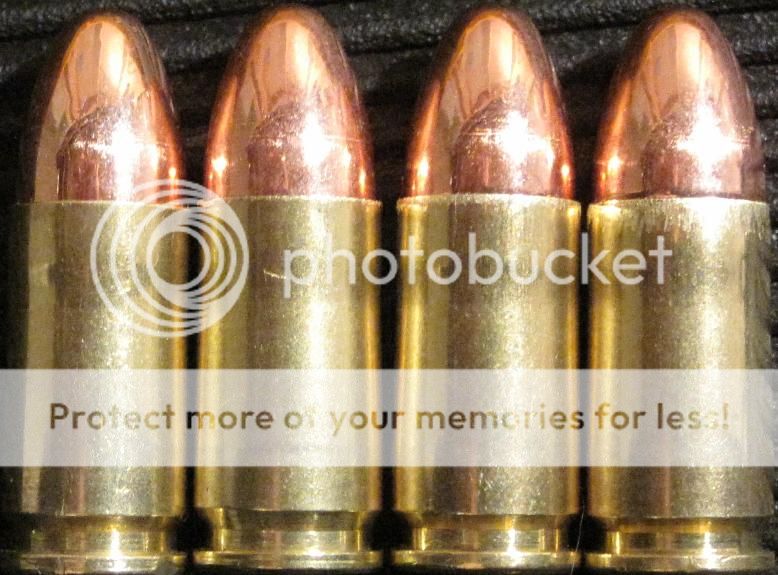

So, it seems I have found the issue. How? I picked up another 9mm Luger LEE FCD while I was buying powder this aft. That's right, I now have 3. Luckily they're 25% off right now.
Anyhow, I went straight to work when I got home and loaded up 20 test rounds to put through the new die, and low and behold they came out looking like they should. Odd.
So I took them both apart, compared and noticed a few things:
1. As smooth as the inside of the crimp bushing from the old die appeared at first, it is not as smooth as the new one(see pics below). There is noticeably more texture in the tapered section of the crimp bushing on the old die. Previously I did not consider this to be rough, particularly since both of my old 9mm LEE FCD's were exactly the same in this regard.
2. The dies had a slightly different stamp (see pic below). The one on the left (G4) is the old die. The one on the right (B7) is the new die. What does this mean? Maybe just different years or production facilities or production runs, who knows...
Crimp bushing from the old die.
Crimp bushing from the new die.
Stamps
Finished round. Crimp to 0.373" from 0.377" at seating surface. Even with a heavy crimp, it looks much better than before.
Stamps
