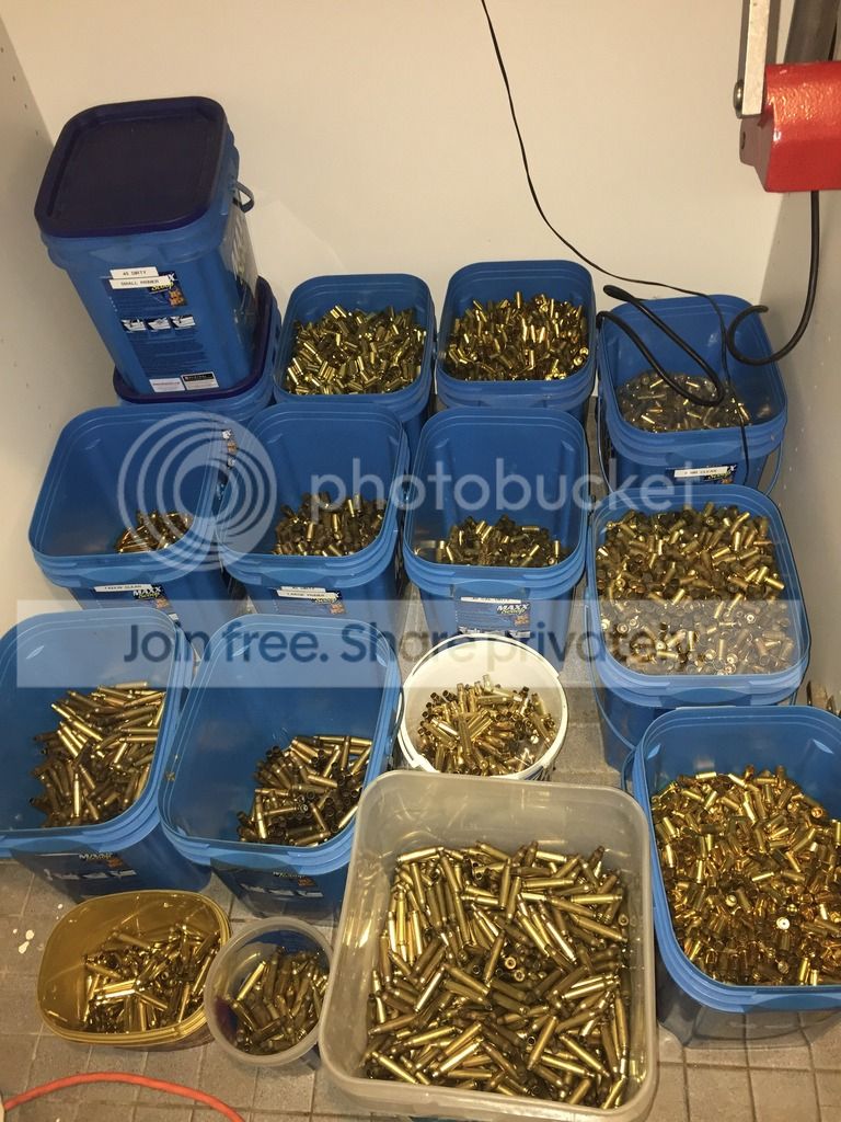

Started out the same way...Anniversary Kit for .45ACP. Love it. Use it mainly for .308, .270 and .257 Robertson (for a friend) since I still have a lot of Norc 45ACP. I have a boat load of .223/5.56 brass so I will start with that soon too. Big fan of the Lee Ultimate 4 Die sets too.
