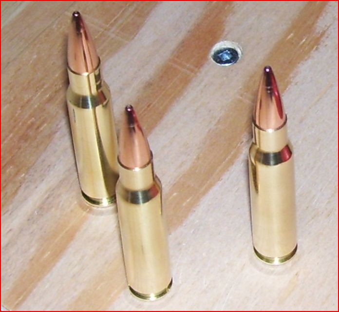

I noticed that there are slight circular marks on each of the bullets I've seated using my Lee die. Is this normal?

I wouldn't worry much about it , but I have to ask, how much pressure are you putting when seating the bullet ? Are the loads compressed ? That would explain the rings.
May be a sharp edge of the seating plug. Take it apart and take a look. If it looks too sharp a couple of rubs eith fine emory paper should help. Not a big issue purely cosmetic. just my .02
I did just that moments ago. There was a sharp/rough edge on the seating plug. I carefully removed the sharp edge with a smooth sharpening stone, followed by a polish with a scrotch-brite pad and then 0000 steel wool. That should take care of it.
I have RCBS dies that do the same thing. It boils down to what shape the seating plug is and what shape bullet it was designed to seat. It's difficult to make a one size fits all seating plug.
As some have mentioned above, round the edge of the plug slightly and that should solve your problem.
