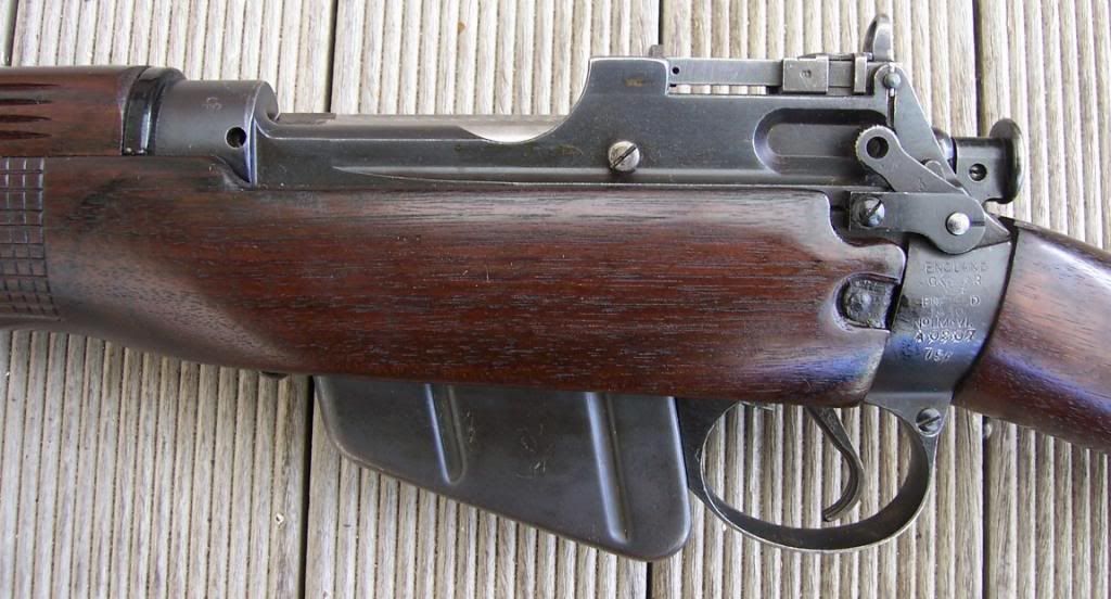

I recently got to see this in the flesh at the Royal Winnipeg Rifles museum (posted a thread in the Pictures forum for those interested), and was really taken by that rear bridge, and the quite beefy rear sight, especially the fine checkering on the sides. One of, if not the nicest machined bits I have ever seen on a LE.
Anyone know of any others on display anywhere?
My word I have never seen a Rear sight on a No 1 like that.Would this be a transitional rifle as the Lee Enfield adopted the form of the No 4?
I have owned two of them over the years and I don't think the caption is correct. As I recall, the Mk 5 failed trials due to accuracy issues. It was followed by the No 1 Mk 6 and that is the rifle that eventually became the No 4 Mk 1.

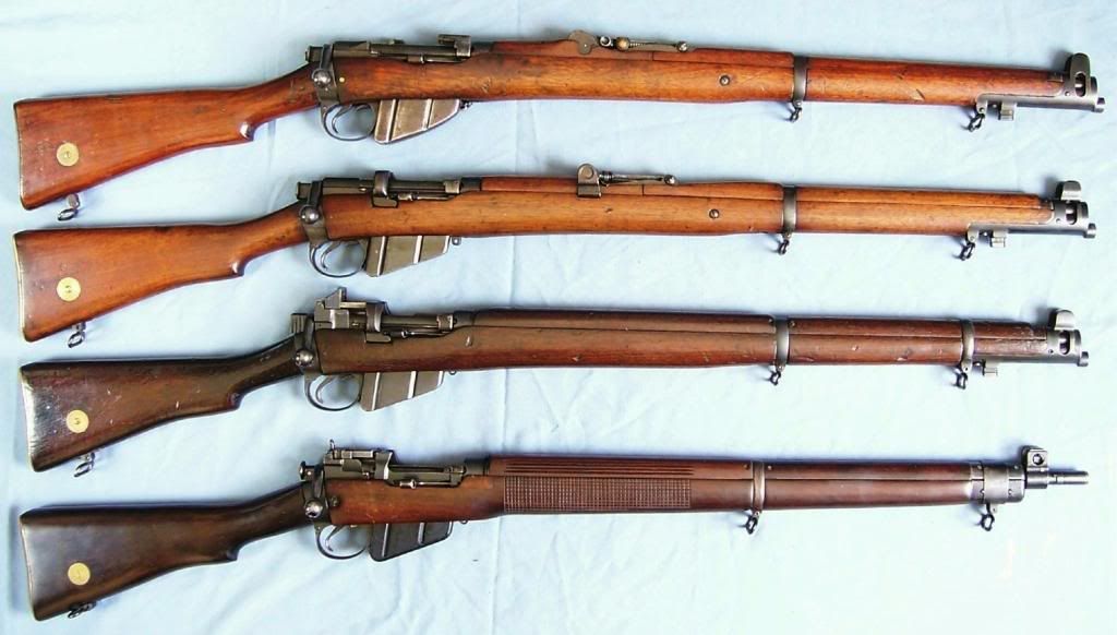

Here's a Trivia question. Do you know what that brown button, (not the steel knob for wind adjustment,) on the rear sight of the top rifle of the four rifles in the picture in the Post above is made of?
And the Winner is ---JP---- with a time of 8 minutes.

I have to say, I think it is the nicest looking of the #1s, with the uninterrupted upper handguard. With a slightly shorter barrel I really think cosmetically it would be the perfect looking LE. Thanks for the pics, great to see these.

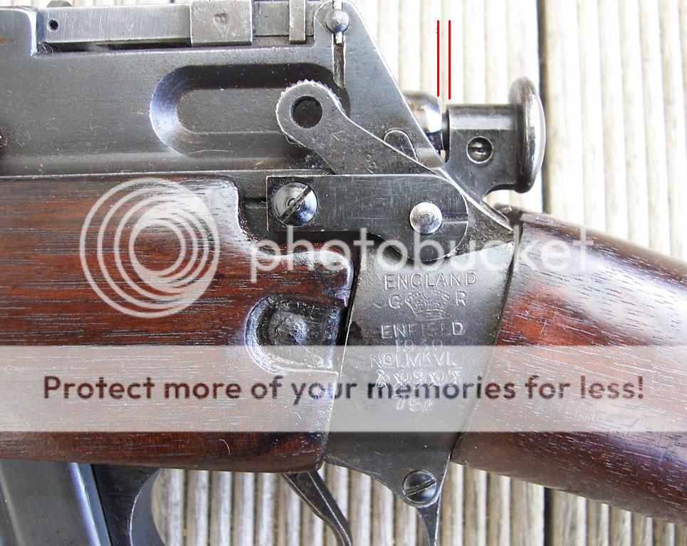

I think B_noser's comments on the accuracy of the No.1 Mk V may be correct.
I noticed that when I fired my No1 Mk5 the back sight would move up and down the long range arm of the sight.
The solution was a threaded adjustable sight as found on the No. 4 and No. 5 Lee Enfield's, the exceptions of the sights being the some war time production.

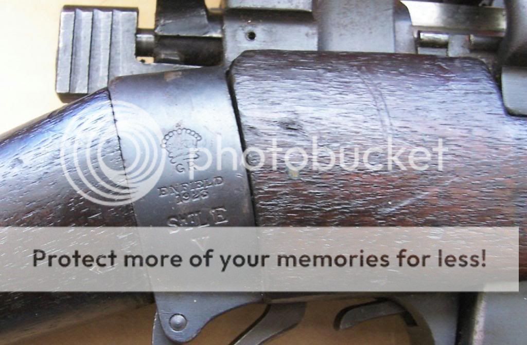

From what i can find both the MkV SMLE (not No1 Mk5) & the No1 MkVI suffered from inconsistent shooting during trials.
The MkV was never fully accepted into service as it was originally planned to convert existing stocks of SMLEs to the MkV pattern but due to problems with alignment of the added on rear sight & the cost & time to sort it, the MkV was abandoned & it was decided to build a new rifle & so the No1 MkVI came to be.
