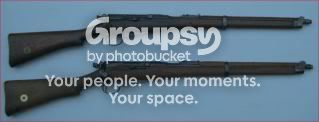

I might have found a source for repro cavalry carbine nosecaps.
I am wondering as to how much interest there would be in me bringing some into Canada.
Picture - Phil Cregeen, NZAHAA
Repop nosecap can be seen on the lower of the two carbines.

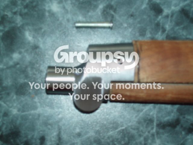

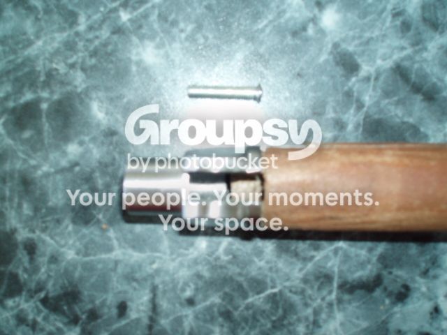

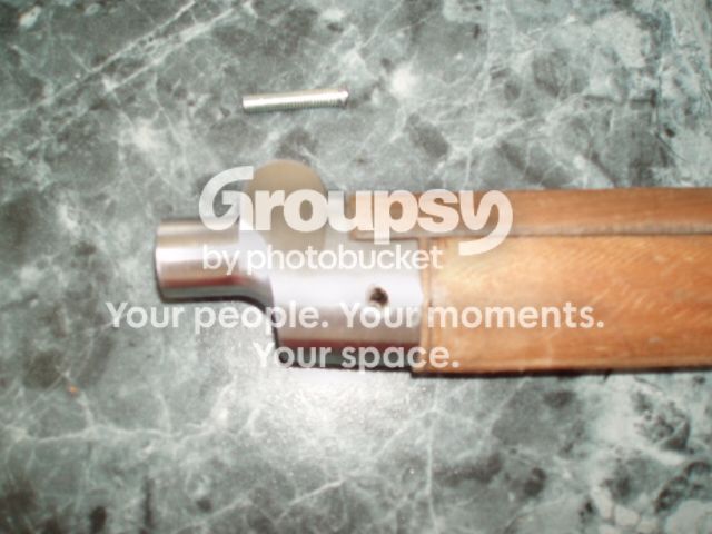

He reproduced a cavalry carbine barrel band retainer for me and it is just a perfect fit! The only thing that it is missing are the inspection stamps, otherwise it is indiscernible from the original.

I am pretty certain the cleanup of the raw castings includes some machining which, I believe, includes machining the surfaces of the tubular sleeve. The two examples in my parts bin both show ever so slight evidence of lathe turning in the area under discussion. I suspect the radius may have fallen victim to some over zealous machining.
