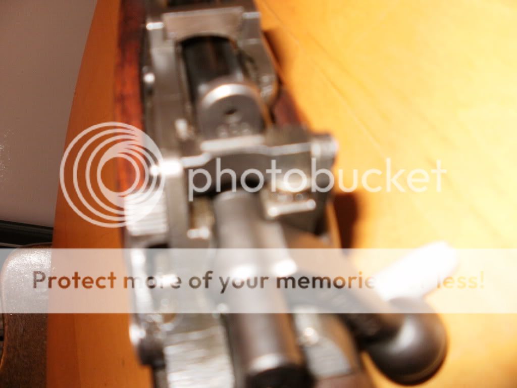

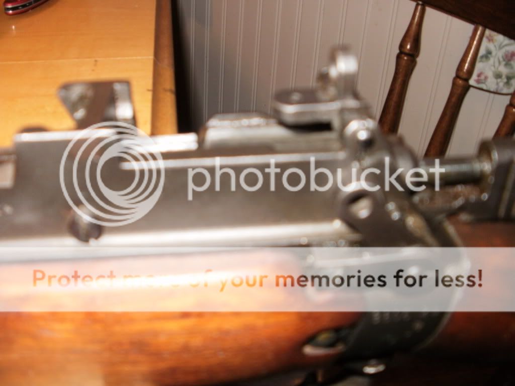

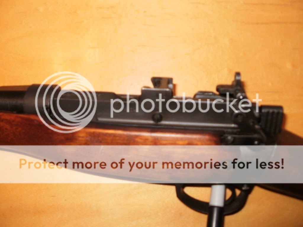

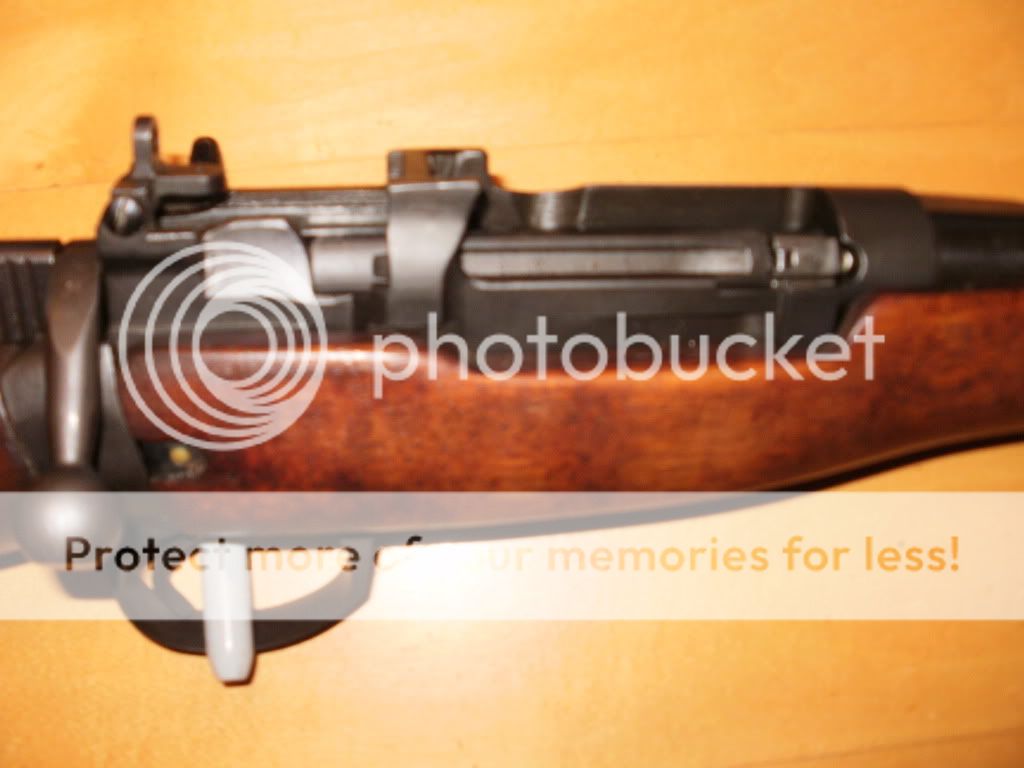

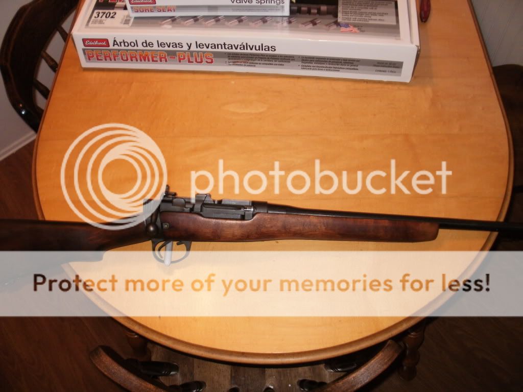

hi i am asking because i want to add a peep sight to my gun and want to get the right one. i have a mint condition 1942 lee enfield no4mk1*, with aprox 20 rounds total down the pipe. my qeustion is what kind of action is it?? p14,p17 what i dont know how to find out. shamefully the stock has been sporterized by previous owner. i will post a few detailed pictures of the gun and action in a few minutes just have to go get the camera. thank you any help would be greatly appreciated.
