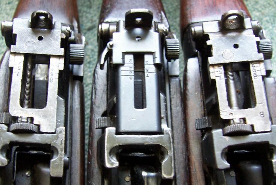

I have seen spacers on rear sight that were made of sheet metal. Maybe it was to tighten up a worn-out rear sight.
Here is a rear sight with a spacer. Middle
Here we should note that the Cdn pressed sight, unlike the British ones, has a full-width base and doesn't require the bushing.
