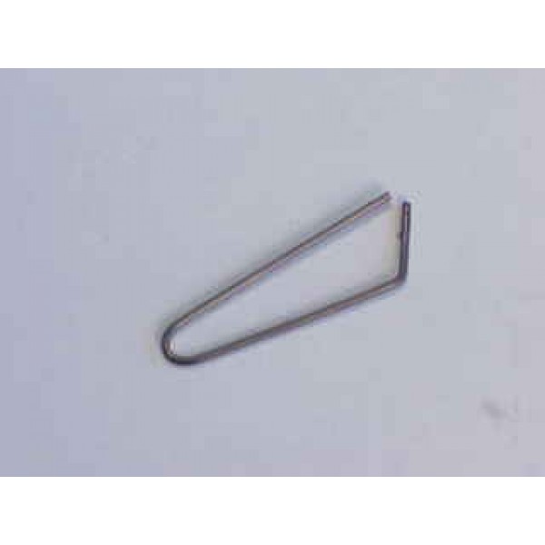

Also make sure the primer actuator clip is still there (at the bottom of the shell plate carrier by the plastic tab screwed to the carrier) looks like this, LINK

Thanks for the info. The primer actuator clip is still there and functioning. But it looks like I will replace the entire shell carrier with 9mm.
