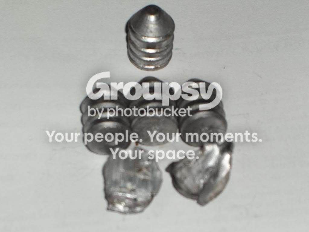

REAL is a Lee Trade Mark. Here's some of my 320 gr ones. The 2 on the bottom were fired through a 4 litre water container into a box of tightly packed papers.
