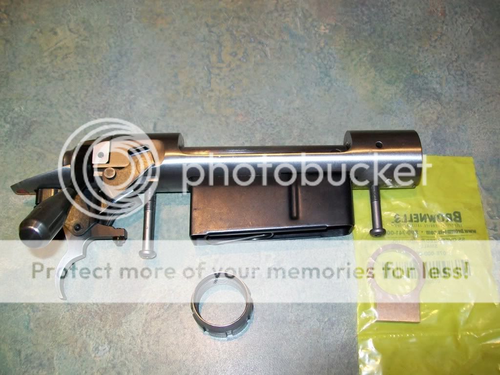

Well this is all I have so Far. Still waiting on Barrel, stock, scope, then the brake goes on.
Here's my "Welfare gun". Savage action, 28" Montana rifleman barrel set up to eliminate the barrel nut, brake, Stockade adjustable stock, Sharpshooter trigger, Sharpshooter bolt handle. Scope is a Mark 4 8.5-25 TMR in Mark 4 Rings. I think I sold it yesterday, since its position has been usurped by a Bat actioned Defensive Edge Canyon rifle. It's pretty much the opposite of a welfare gun.:D
