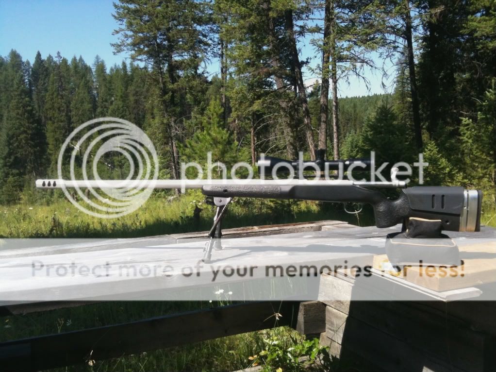

Here is an old pic of my edge, ATRS built, Rem stainless action, 30" barrel. Pushes the berger hybrid 2930fps. Yup that's a Bushy 4200 tactical, I was going to replace it with a NXS or mk4 but the glass is good, it tracks very well, has enough elevation to reach out to 1500 yards and I don't want to mess with success. The only thing added since this pic is a vortex bubble level from One Shot tac.

Nice groups!!! My brother is in Cranbrook...seems like some nice country around those parts.
How is your rem set up with regard to the magazine? Nice looking gun btw
I have a 4200 tactical on my .338 lapua, was supposed to be temporary but now it staying, had good success with mine as well. Trying out a 6500 on my .260
The area around here is very beautiful, the town itself is just another small city with a big housing price tag, I was house shopping this afternoon :( But the mountians here make it well worth it!
It was chambered to seat the sierra MK to factory BDL mag length, I can touch the lands and still fit the mag with everything but the bergers I single load the berger's. The top round in the magazine gets deformed under recoil, it will break the tip off of an accubond or dent a mk, the TTSX is the only bullet that seems to survive in the mag. I might go to the Seekins bottom metal or the wyatts box just to see if that gives enough room to not crush the tips. Maybe I will make a box myself with a little ridge near the shoulder to stop the casings from moving.

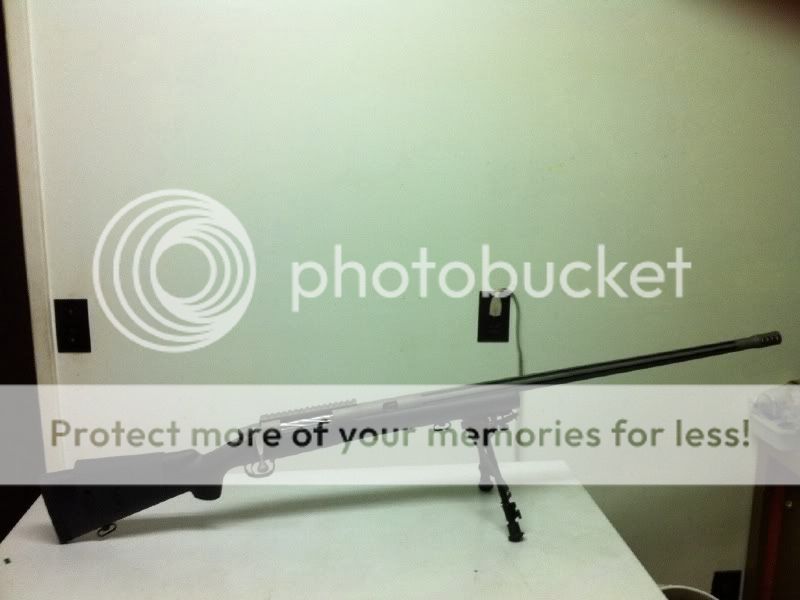

Here's my second Edge, just before I bought it. It's wearing a 8.5-50 x 50 Mark 4 with TMR now. It's a Shawn Carlock canyon rifle, built on a Bat repeater action, 30" fluted Hart barrel,DE brake, Jewel trigger, HS Precision stock with Carlock adjustable cheek-piece. Weighs 14.7 pounds, scoped.
