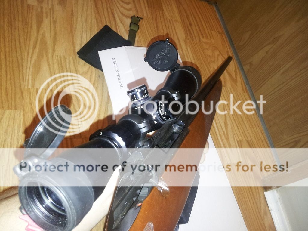

Ive had these for awhile now:
P&D mounted it maybe 5 years ago. I forget the name of the guy who did it. The guy who said he used to be US airborne. He did a good job lapping from what I can tell. The torque seems to have been set properly. Seen a few hundred rounds and the screws seem to have maintained their position and I haven't lost zero ever.
