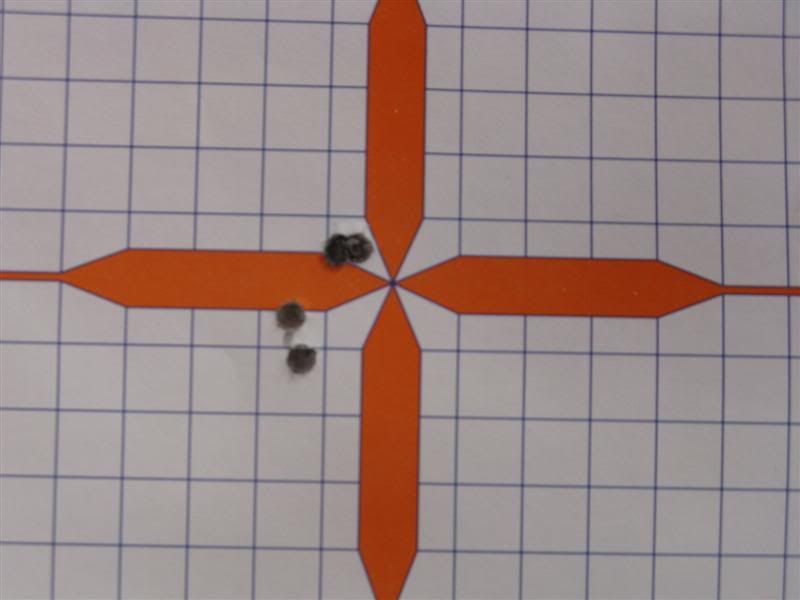

If this was only a 3 shot group it would have been my best. :redface: Sadly it's 5. I'm still in the load development stage with the 1 in 7 twist .223 Model 12 LPV. This is a pic of a 5 shot group from today (100 yards) with 50gr V-Max bullets and 26.4gr Benchmark powder. I'm going to load up 12 more and go out in the next week or so and use 2 to warm up the barrel and try a 10 shot group. There is approx 80 rounds down this barrel so far. I'm thinking the two flyers are my fault. I'm hoping anyway.
I didn't want a 1 in 7 twist. I ordered a 1 in 9, but after 3 months waiting I settled for this one. If I can shoot some really small groups with this thing I'm going to go on the record saying that 'fast twist heavy bullets only' is pure malarky. It doesn't look like it's spinning the bullets apart so I think it will give the usual (excellent Savage) accuracy with any bullet weight. I had read (somewhere on here) that the reason some bullets 'disintegrate' is they get too hot from the rotational speeds and the lead melts (or something to that effect). Maybe that's with cheap bullets?

Go long/heavy. I wouldn't waste my time on 90's but bullets in the 80 grain neighborhood should absolutely rock if the barrel is a good one.
KDX, you are off to a great start. Were the first 3 that clustered or last three or????
If you haven't bedded that action, do so. That is a huge area for improvement.
Then keep an eye on your scale. I want my powder charges to be the same tenth (under actually). Alot of scales are +/- 0.1gr or 0.2gr worse case spread. That can lead to the type of groups you are seeing.
Also try 0.1gr above and under where you are now. That can help tighten things up. yes, powder changes that small WILL show up on paper with many 223's.
Then the usual stuff like wind, mirage, conditions.
There is absolutely nothing wrong with shooting the lighter bullets in the fast twist. A 223 simply can't push them fast enough to blow up. Try this in a 22/250, and you will likely see problems.
However, do try the heavies as was suggested. The LR performance is so much better and 1000yds will prove to be not that far to reach.
Looks like you are well on your way to getting a great shooter.
Good luck and enjoy...

I think it was the first 3 of that group. I had shot one 5 shot string prior to that that was 26.3gr that wasn't as good. I'm using a Caldwell Fire Control full length rest and I think I need to shoot a little more with it. I just started using a Charge Master 1500 combo and am hoping the weights are OK. I never checked the charges on a beam scale. I bought this rifle primarily to be a 300 yard and under gopher/paper rifle.
Shoot 2 5rds groups at 26.4, 26.5 and 26.6. Plot where every shot goes and why. If it is going to tighten up, it will do so somewhere here. If you keep getting flyers, then the work really begins.

Thanks for the advice.;) Hopefully I'll get to do it in the next week. For some strange reason work interferes with my life.
Fire a ten shot group and see if the extra holes don't just fill in the gaps in this group. A lot of the time "flyers" aren't flyers.
Don't feel bad about 5 shot groups.
Really, I think the origin of the 3 shot group was people trying for a good 5/10 shot group, but stopping at 3 because they're scared to put more on paper (and potentially widen their groupings) ;)
