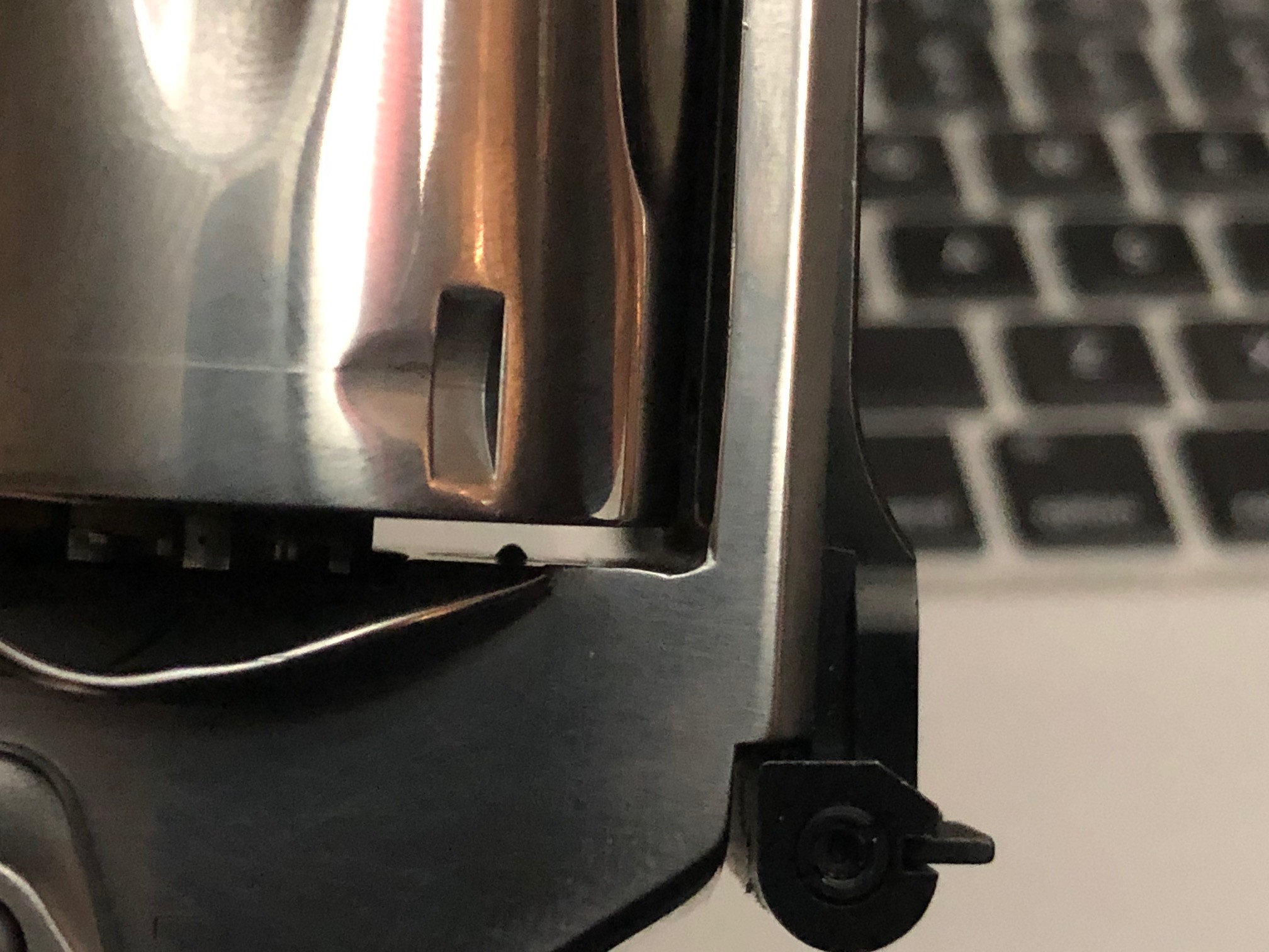

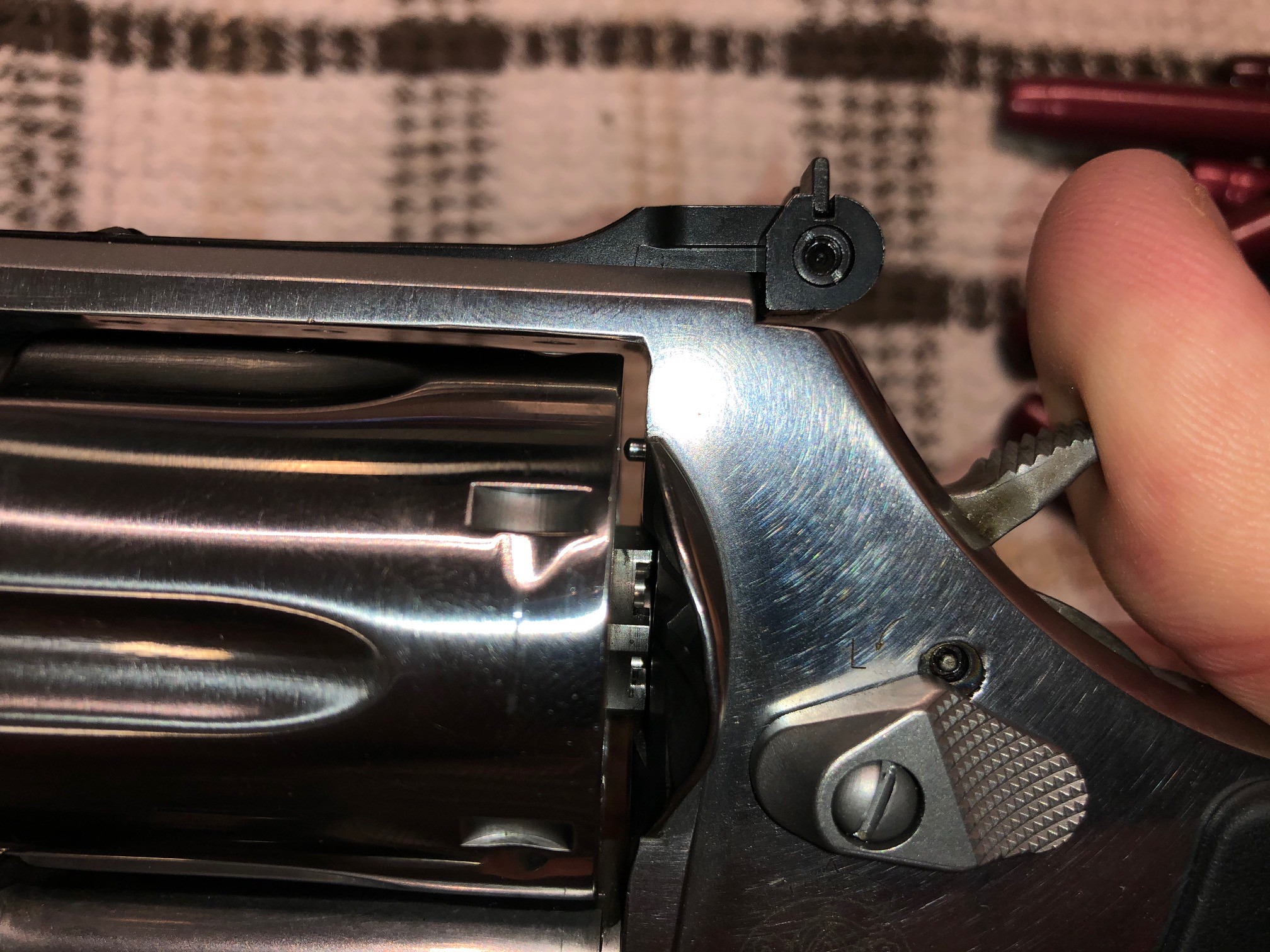

I did, however, notice the following:
1. The cartridges have around a millimeter of play between the face of the cylinder and the surface where the firing pin protrudes
2. The firing pin doesn't seem to protrude very far compared to my old .38 special service pistol back in the day (if I remember correctly)
I was able to have it fire more reliably when I would tilt the gun back before every shot allowing the cartridge to shift back and rest on the firing pin hole.

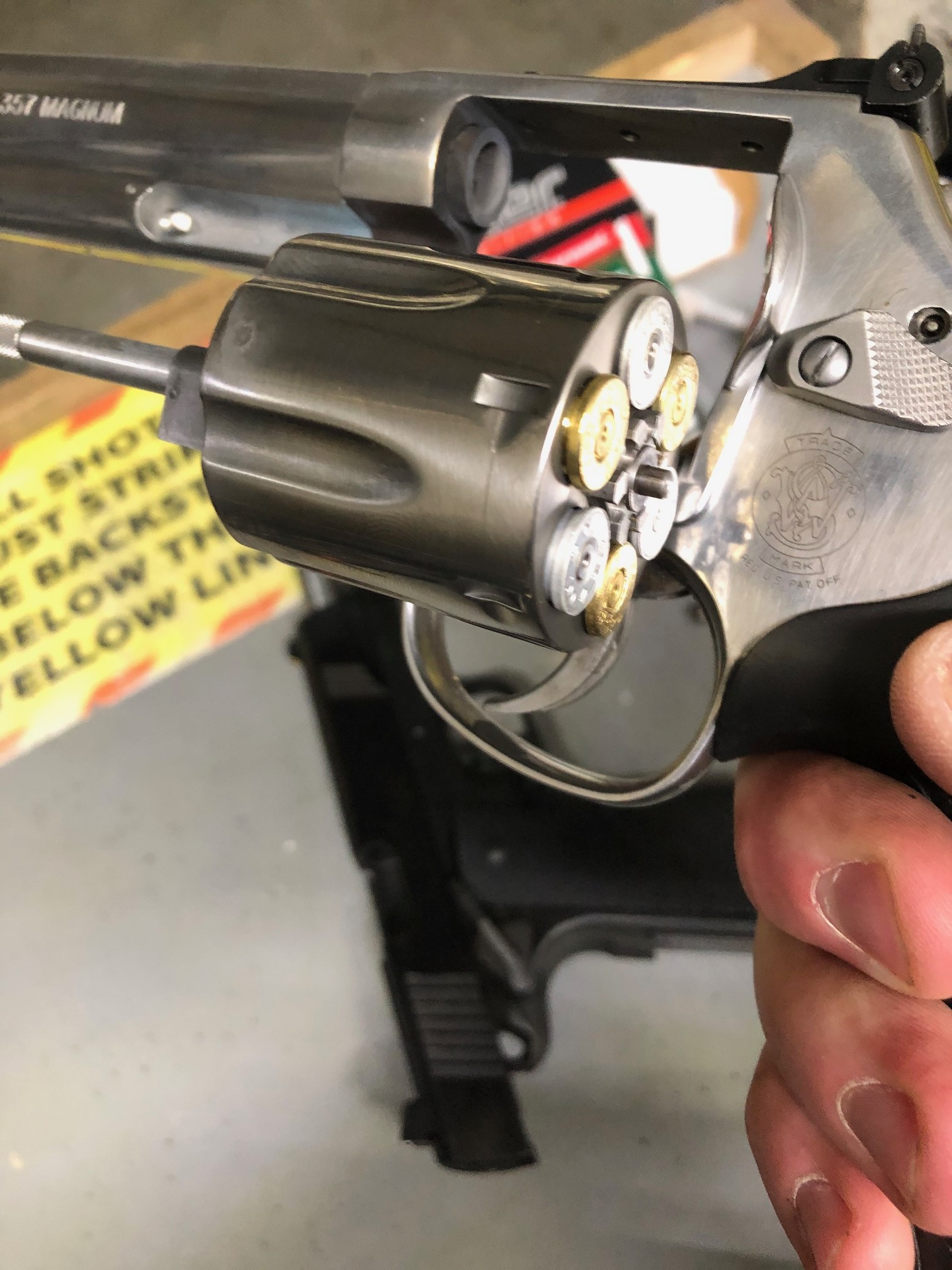

In your first picture, looks like some ammo is not seated, or is that just the way you took the picture?
A mixmash of ammo? shoot some factory stuff.
I small difference in rim thickness should not matter.

If your ammo is not seating onto the cylinder face you will get miss fires all the time, dirt in the cylinder holding the cases back a bit and they will be pushed ahead by the firing pin, but now power left to fire the primer.
That is what your first picture looks like to me.
I took it that way just to show around how much play there is with the rounds in the cylinder back and forth when the cylinder is closed.

Close the cylinder on those rounds and take another picture.
If there is that much free play with ammo in it and closed, something is buggered.
any end shape in the cylinder when open ( back and forth) should not be on new gun
That ammo should be O.K., I shoot lots of Blaser ,there is better stuff, but cheap and it works o.k.
Do you have a feeler gauge? if so close the cylinder with some fired rounds in it and see what the space is. I don't know off hand what the spec should be,
but not much.

I see you checked that screw. Sorry I missed that in the first post. Place the spent cases back in the cylinder and check the gap between the rear of the cases and the firing pin face. It’s best if you can punch out the used primers to help get a more accurate reading. That’s the headspace. 0.010” is about right but 0.008-0.012 is acceptable. You’ll need feeler gauges to check this.
If the gap is more than 0.012” you’ll have to send it back. Your firing pin looks the same as my 686 but we’re talking thousandths of inches here so it may be the pin.

For guns with in-frame firing pins. Swing the cylinder out and hold the cylinder latch to the rear. #### the hammer in SA mode then release the cylinder latch. Use a tool to push the firing pin forward (it's located where the nose of the hammer would strike). Hold the gun muzzle up so you can view the firing pin sticking out of the bushing. Place a .030″ gap gauge on the recoil shield while holding the firing pin forward. The pin should be at least as high as the gap gauge.
I think you need three hands to do that. I tried to measure the pin protrusion on my 625-8, albeit w/o pushing the hammer forward, but with the hammer in the "fired" position and as far as I could tell with a couple of feeler gauges, it was about 0.32, but I can't be exactly sure.
