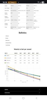

Light bullets is certainly an option. Depending on the ranges you might find a mid- weight bullet with a decent BC is a better option though, the light 30cal bullets tend to have garbage BCs and lose velocity fast, so at longer ranges they don't really offer much of an advantage.
Federal's lightest offer is a 130gr, but as you can see below the 150 fusion and 165 trophy copper both eclipse the 130 by 200yds despite slower initial velocities.
