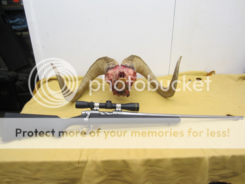

I did up a short 700 in 300 WSM and came in at 5 lbs 15 oz with a Leupold 3-9X36 VX II compact.........started with a 700 Ti rifle. I opted for the Brown Precision Kevlar stock which weighs less than a lb all up finished and is tougher than a pig's nose.
I am doing a Mod 7 in 300 SAUM for my #1 son right now, started with a stainless/synthetic and am about to start lightening it up......target under 6 lbs with scope. Doubt I'll make it without the benefits of the Ti action to start with but should be able to get it to 6 1/4 pretty easy.
When I built my own I decided what I wanted and spared no expense to get as light as possible. I did the work myself.....there wasn't much really, but I addressed everything that could be made lighter. The original Mod 700 Ti already had a fluted and hollowed out bolt and fluted barrel, so no extra cost there. I went with a PT&G lightweight speed lock firing pin assy and a PT&G aluminum bolt shroud.......significant weight saving in the bolt shroud!! After weighing many types and makes of rings I ended up going with ugly but functional and light Weavers.........They are as light as any and one can buy exactly the right height combo of ring and base. I went with the Leupold 3-9X36 VX II compact scope, these have some down side aspects but work on this rifle just fine, for what I built it to do. One is not usually short of light when mountain hunting and this scope has proven it is all one needs for sheep hunting. It is not the absolute best and clearest optics but I was willing to sacrifice a little optic quality for the light weight.
Total build cost was just over $4K..........was it worth it ?????????? Maybe...........

BB15........I really didn't do anything to it, I changed the firing pin and bolt shroud..........5 minutes........and bedded it. As it is a Kevlar/carbon fiber stock, I ordered it completely finished........I tried to finish one of them years ago and learned my lesson.....never again !!! All told I doubt I have an hours labor in it..........
By the by BB15.........there is a Ti Model 700 in 300 WSM in the EE right now..........not cheap but they are light and already have fluted barrel and bolt..........under 6 lbs as is and ready to scope........
