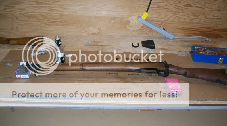

So, when i ordered all these parts, the lower handguard is 'new'.
The front upper is 'new', and the rear upper is 'gently used'.
The stock was probably used in the D-day attack, as the dings, and dents make it look, not bad, but still, not great.
I did the ultimated 'evil' thing to a milsurp and hit it with some 180 grit paper, I know, horrible.
But if you seen it, it was just that bad.
The front parts all seem to match up, and I'm sure they're all walnut.
The stock seems darker, but I think it's walnut, it's not much darker, but if I notice it, I'm sure you lot will..
Ugh, I'm gonna get flamed for this.

So whats with the butt stock being darker? Did I fail?
I'm not a wood expert by any means, but that looks like a walnut butt and beech/birch forward stocks.....look on EE I saw a guy selling enfield butt stocks for $25, I'm sure one of the many he offered would be a match or alot closer to your fore stocks.

The weird thing is, the furniture up front was different colours in the beginning too, I'm wondering if I apply more coats to the front, maybe then I'll be able to even them up.

No harm in trying. You might end up more $ in time and materials trying to match the wood colour than $25 and match the buttstock to the fore wood though. my .02

Leather Dye!.....You sir are Brilliant!! That is a perfect match. I keep scrolling back to the pic as I'm typing this and I just can't believe how well that worked!! I would recommend BLO topper to seal in all that lovely tone and give that fine rifle the sheen it deserves.....Wow that is just fantastic.....maybe there's something to that girly lemonade after all:p
