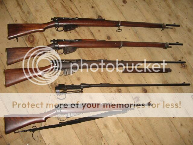

Take some pics and post your project for us to see. This board is a great resource and there are some very knowledgeable people who are willing to help. As for reference pics, what do you need to see? I have camera
