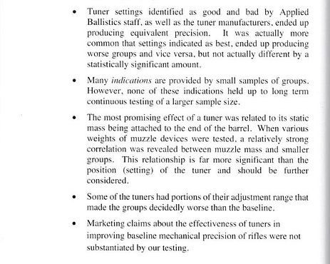

Yep, and I agree, in theory, tuning the harmonics of a rifle barrel should work.
Years ago I was involved in a test on the cryogenic treatment of rifle barrels. We used three shooters, including a benchers champion and we used multiple different rifles of different calibers. The long and the short of it was that cryogenic treatment helped the most with crappy barrels, because clearly they had the most internal stresses. Good quality barrels mounted properly in a high end action and bedded properly saw much less improvement from cryogenic treatment. Cryogenics was all about reducing internal stresses in the metal, which ultimately affect the harmonics of the barrel.
I think Jerry has a valid point as well, and as an experienced shooter he is pre-conditioned to be able to realize the improvements of a tuner, where the majority of shooters are simply not.
