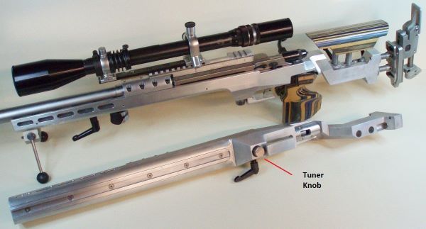

It's not clear at all that remounting a tuner and expecting it to do its job is comparable to remounting a scope and expecting it to remain on zero, especially at longer distances. The use of quality QD rings may help in remounting a scope and having it close to zero, but it's not the same as using an indexed collar on a tuner. The purpose of the tuner is to have a weight set forward of the muzzle at a certain distance. An indexing collar allows for that.
If reproducible results are possible after removing and replacing a tuner, an indexed collar is the only way that it can be done. For reasons of length when transporting a rifle with a tuner, the tuner must be easily removable. A Harrell tuner add at least 2.5" to barrel length, a Starik tuner tub considerably more, at least 7.5" on the shorter one shown in the picture above.
