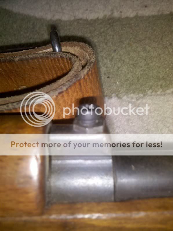

I had a gunsmith simply tap the threads in the existing gas port screw and install a standard torx screw. Easy to adjust and now my brass merely falls at my feet or on the table beside me. No more crushed necks! Sorry for the poor picture quality but I did this on my phone. The alteration cost me 20$ and was done by a local gunsmith. The screw isn't high enough to interfere with the sights either.
