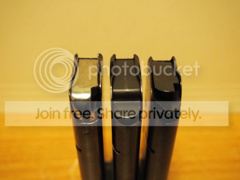

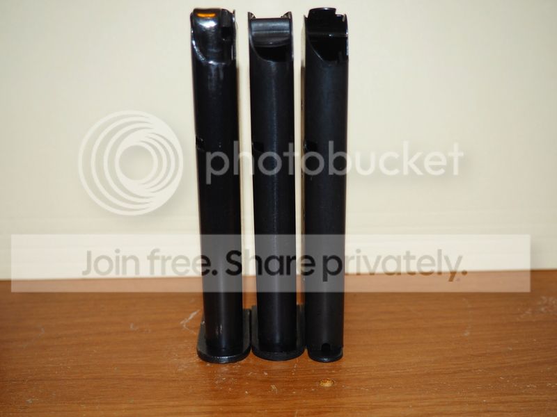

Original on left, Triple K for Llama IX-A middle, and Chip McCormick for Colt 1911
Note wide base plates on Llama mags. Regular 1911 mag would need the the mag latch opening move up a bit to lock up.
both Llama mags seems to have some up and down play when supposed to be locked up.
