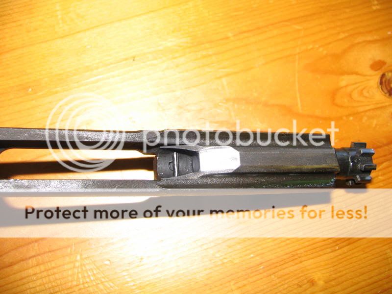

Bolt bottom pic

I think i see it.Pics coming
Ok..i see a wedge shape there were the hammer could be getting binded in after firing.

The two shiny marks on the carrier in the center of the pic?
Yes, I suspected that the hammer is making contact there. The question is why? I've used it with other uppers and never had a problem.

Well if the fit was tighter,or a difference in tolerances could bring the hammer up further into that groove.So your hammer is striking even a couple though higher on the firing pin.
Than could be enough to get it wedged in there and bind it up.
It looks like the carrier is at fault due to the design
Hit it with a file or polish the sides and the top of the hammer.

I was looking at your pics and noticed that the firing pin was missing from my pic. I never thought much of it as I regularly run that bolt without a pin for use in a teaching gun, and without any problems.

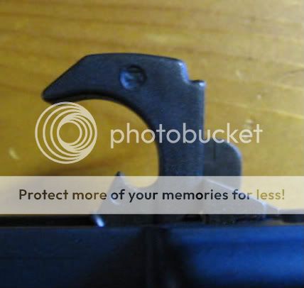

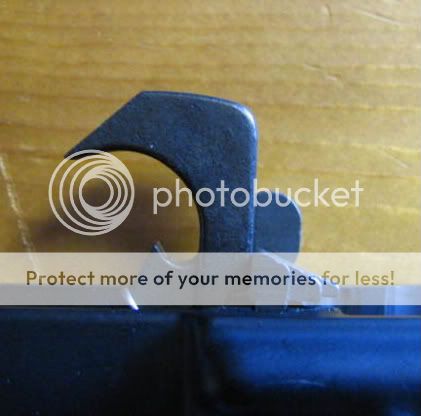

Now here's the tricky bit ... I always use the lower with the old style hammer in combination with that bolt as a 'trainer'. It appears that the non notched (old style) hammer works happily without a firing pin. The notched hammers do not!
Case closed, I think ....
Old style hammer ...
Newer style hammer, notched to prevent slam fires ....

I suspect that it was the 'notch' in the hammer that was binding things up. Well, I just learned something new. Now to get a worn out AR15 firing pin and chop it down for use in my training gun.
