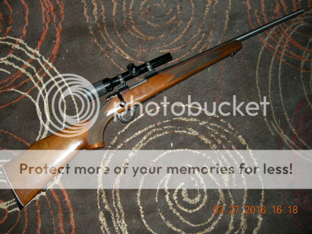

A few months ago I acquired this Sako L461 in 222 with a pitted chamber and bore. I had a 12" twist Gaillard barrel sitting here for 2 or 3 years that I had bought off the EE.
So, I put the two together, chambered it in 223 and sighted it in with factory WW whitebox ammo and got 5 shot groups under an inch. It now wears a Leupold VariX-II 4-12AO.

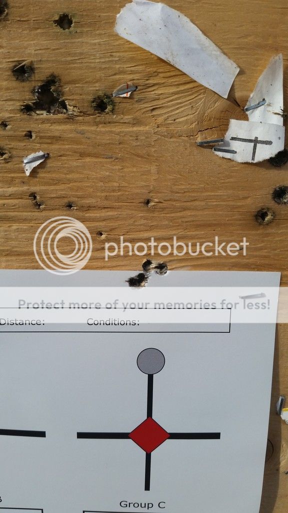

Then I decided I should try the handloads I had loaded for my 700 223 about 5 years ago. A 40 gr VMax over some H335. This was the result. Load development finished...:)
Particularly nice because I have about 300 rounds loaded.
