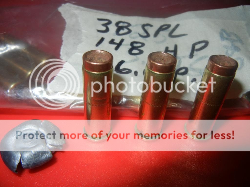

A 148gr HBWC in a .38 special loaded down side up expands to almost .70 caliber even at 750fps! Old Texas Border Patrol load for 2" hideout guns.....they went through one side of a steel 45gal drum at 100 yards out of a 4" S+W model 10........Harold
Yes. I loaded some HBWC cavity up in my 38Spl. Worked very well in a water test.
