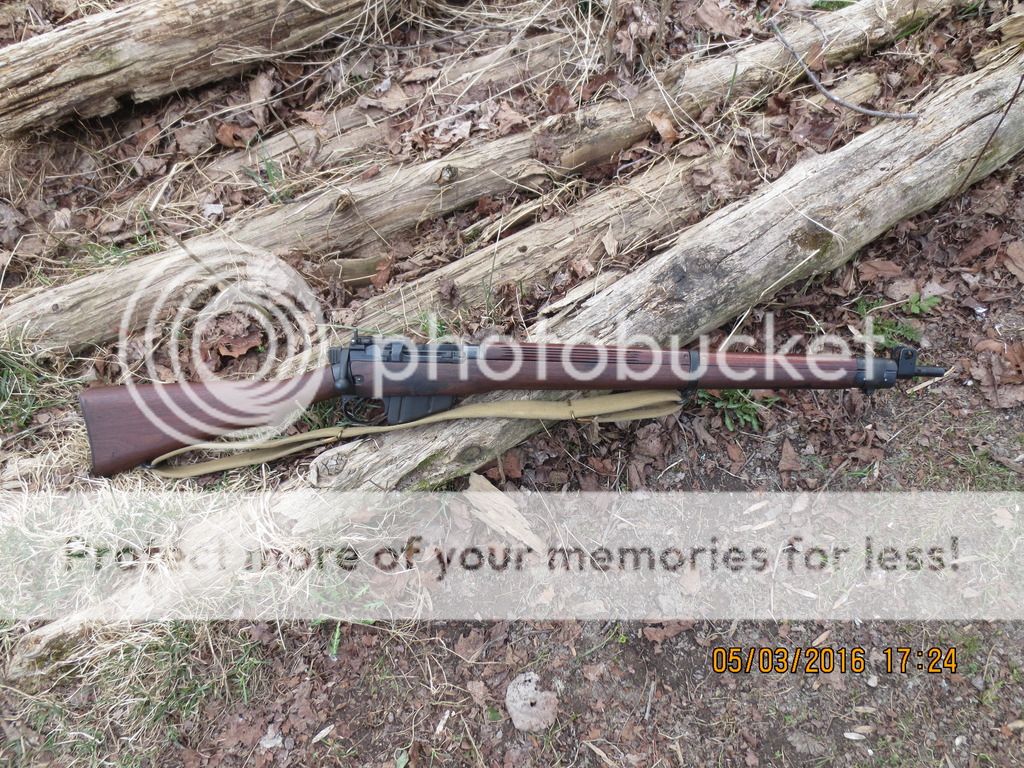

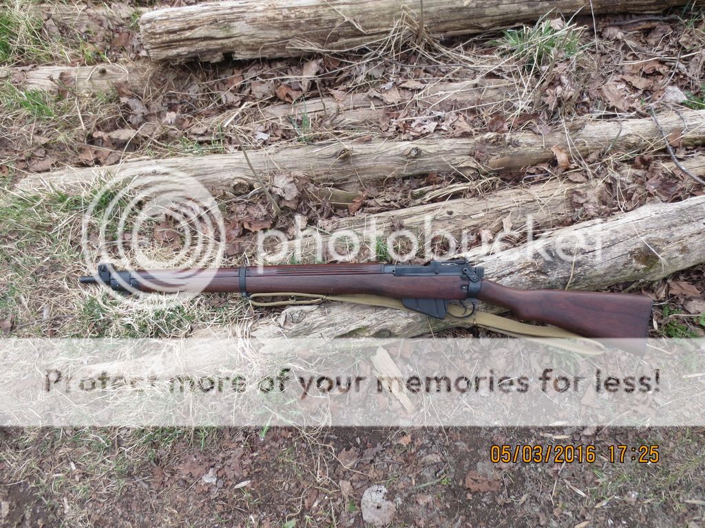

Hi all,
I recently picked up a Long Branch 1945 made rifle, and it is turning into a bit of a project. Would be interested to hear any info you folks might share about this one, as I am not a super knowledgeable guy on their markings, etc.

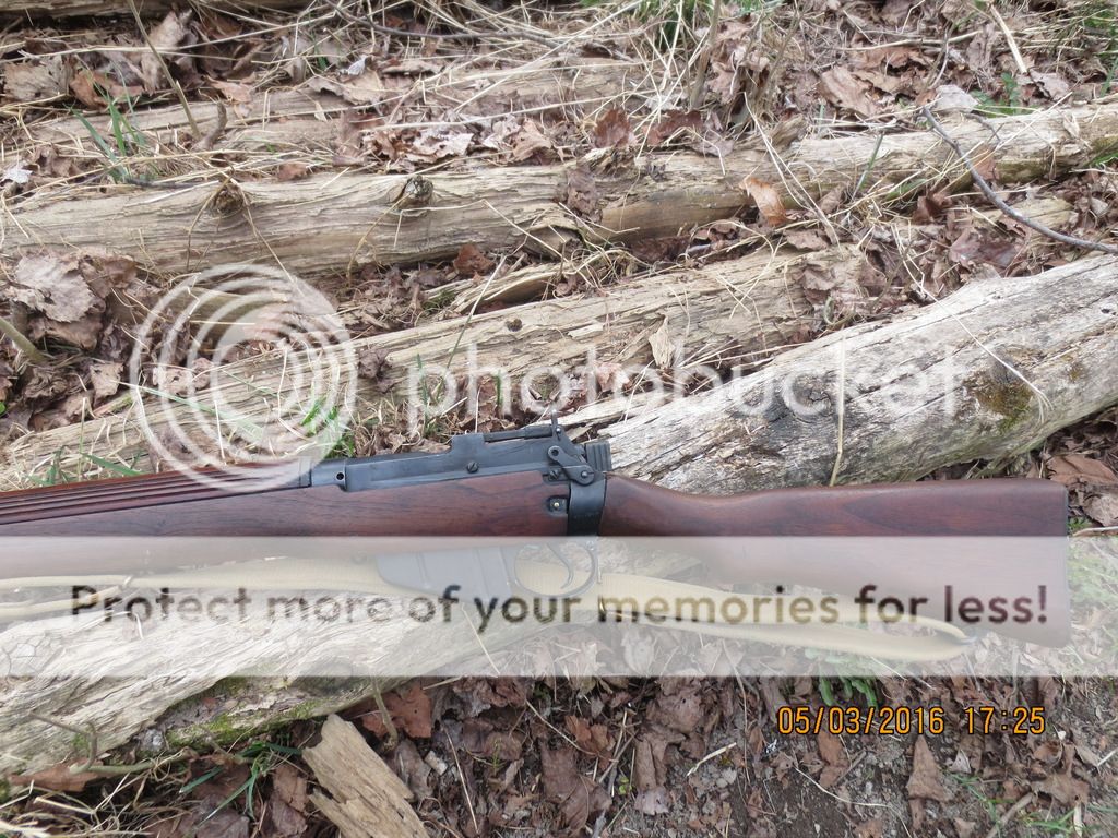

First of all, the stock is super clean, and very nice walnut. L marked butt, which is good for a big knuckle dragger like me. Top pieces do not look like they match. Wondering if a stock this nice is a replacement or maybe NOS? Finish is in super shape and there were actually traces of very old cosmoline outside and inside the action. Someone had cleaned it and fired it, but not very thoroughly and the bolt was a little gummy to work. I removed what remained.
Bore and rifling are super crisp and new looking.

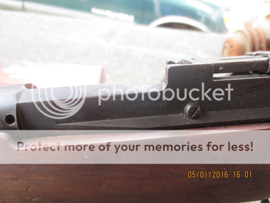

Bolt body and mag match the rifles serial number. Cocking piece, safety do not seem to.

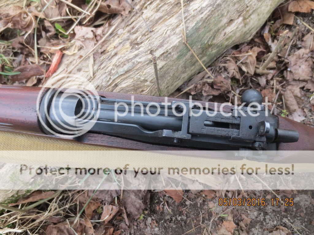

Strangely the front sight is the shortest one they make (-.3) marked. And the rifle seems to shoot very high at 100 yards. I say seems to because I only fired two factory Remington rounds. The second one produced a lot of smoke, and it turns out it had a pierced primer. I packed the rifle up and went home.
Guessing my first move here should be picking up a headspace gauge before messing with anything else? Bolt has a No 2 bolt head that looks visually in great shape, and is .634 in length according to my caliper. I have a hard time seeing a rifle this nice having excess headspace.
Anyway, here are some pics. Thanks in advance for whatever intel you fellows can provide!
Did you buy this around Calgary? The butt stock is sanded and the stock set looks like maybe a leather die was used to blend wood to match.
Slings on backward. Check your firing pin (pierced primer thing) and don't be overly concerned about shooting high at 100 yards (these are 300 + yard rifles). Aiming at center of mass (and lower {read belt buckle} if closer than 300 yards) will place rounds between the nipples of (unzee) target.
Lee Enfield; putting round holes in square heads for over 100 years! :)

mr.e moose, this one came from a fellow in Quebec actually. If someone did sand and finish the buttstock, they did a very good job. It would explain why it looks so new. It does seem like it was not properly fit to the rifle right behind the tang, as the cocking piece rubs a tiny bit on the wrist of the buttstock when you operate the bolt. But just enough to say.
Plinker 777, indeed! Thank you! I guess it does sure still suit the purpose. I would not be too concerned if it was shooting high with the big ol 300 meter battle sight, but it was quite high with the ladder up and set to 200 meters also. Think I will swap that front sight out.
Firing pin looks a little pointy, might need to be blunted/rounded off a bit. And the primers were sticking out past the case a couple thou, enough to feel with your finger anyway, not sue if thats enough headspace to worry about.

Taller front sight will cure a high shooting rifle. That is why they were made in numerous sizes.

That is a good looking rifle :) The upper handguards are very likely not the same wood as the lower handguard or stock, so if they're not exactly the same that's normal. It could be NOS wood stained to match and oil finished. It could also just be extremely well taken care of/new. It 100% does not look sanded to me. I have a Fazakerly no 4 with a NOS wood set and it fits a little big too nothing to worry about. Mine's "L" marked as well and I like it better even though I'm a dwarf :) The bands should be tight. Is the wood loose underneath the band, or is the band just loose? You can try shimming the lower forestock under the barrel and under the rear handguard at the rear. I've never been able to figure out exactly how to measure the exact force exerted against the barrel, but I do know that it's supposed to have upward pressure at the nose, and shimming in this way will accomplish that. I use plain paper.

As mentioned by mr. e moose, the buttstock has been sanded; You can see that it's rounded where your pinky finger normally rests, originally that part is "sharper":
