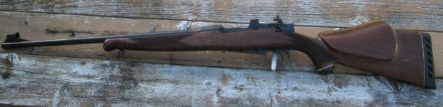

There is a photo of one on the table (second from left) along with a number of other trials rifles. Notice the distinct butt-pad. Photo taken at Long Branch.
Two thoughts come to mind - the Lightweight No.4 rifles which are neither No.4 or No.5, and the EAL rifles. There was a specification survival rifle similar to but not the same as the EAL.
The rumour is second rifle in from the front. Notice the Long Branch type convex barrel band.
The No.4 at the back looks standard but for the fiddleback grain in the wood.
