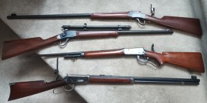

I have 5 Winchester 94’s. Four of them don’t rest the barrel on anything. Two like being rested on the front of the action. Two on the forearm. And one it likes resting just behind the front band. So try a rifle and see where it likes being rested.
