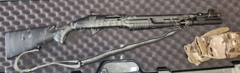

I'm looking for a flashlight for my Benelli Nova 3 Tactical.
I won it last year in a SFRC bumper sticker raffle so I decided to upgrade it a little since it was essentially free.
Ordered a GG&G 2 shot tube extension and M-Lok barrel clap in November of 2025, just got it and installed it today.
Shotty only has m-lok and I don't really want to have to use a picatinny to m-lok adapter.
Any ideas?

Following for interest… I’ve passed on these because of this exact reason.
Could not find an elegant solution to get a light on it.
I would like a remote momentary switch.
There are a lot of lights that use M-lok but the switches seem to all use picatinny.
And the few adapters that I've found for the switches don't ship to Canada.
This would be perfect but they don't ship to Canada
https://www.shaffermachining.com/product-page/streamlight-pressure-switch-m-lok-mount
SureFire Scout lights come with both MLOK and Picatinny mounts. You could get something like the DS00 or UE tailcap (I’d recommend the former since it’ll have push button for backup) and get a tape switch to the forend, just position it so it lead is less of a snag risk.
Magpul makes MAG617 which can mount the previous generation SureFire switches to MLOK but is quite long, but you could also just buy some heavy-duty Velcro and make it so you can easily remove the switch. SureFire also has newer switches that are MLOK. There are some aftermarket switches too that can mount to MLOK such as Unity Tactical AXON when you buy the adapter
