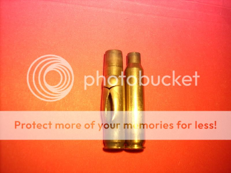

Murphy works overtime. If a cartridge will chamber, it will sooner or later get shot in the wrong rifle, by accident.
Never mind the guys that do it on purpose, because they thought their 3006 was a 308, or that their 32Spl was a 30-30.
I own a lot of rifles where the same gun is available in several calibers, and I do a lot of shooting (3X a week for 50 years). I have managed to fire the wrong ammo in many guns, because i have the same model gun in multiple calibers.
I have shot 9mm in 40 S&W. 40 in 45ACP.
7x57 in 8x57
308 in 3006.
223 in 7.62x39
The pistol mix-ups happened by putting the wrong mag in the gun. It chambered the smaller round just fine and the extractor held the case against the bolt face well enough to get ignition.
The only mix up that had a satisfactory terminal result was the 308 in the 3006. It sounded just fine; recoiled like normal and put the bullet on target.
In the 7mm in a 8 mm rifle example, after the shooting session I wondered why I had 21 8mm empties and only 19 7mm. A study of the headstamps explained what had happened.
I have never fired a 308 in a 7.62x54R. They look so different, it is hard to imagine doing it by accident. And I don't have an example of any similar rifles chambered in both calibers.
