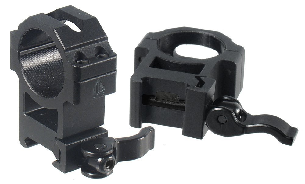

In a normal scope ring, the pressure to hold the ring still is exerted by the screws - torque them down, and the ring doesn't move. However in a QD situation, you normally cannot put enough force into holding the rings stable. When you flip over certain rings, you see the bottom of the bolt that crosses underneath. On a rifle with a bit of kick, that rounded profile of the bolt can chew up a scope rail as it is almost impossible to avoid some slip:
(UTG shown for demonstration purposes... but these are great on my .22s)

For a couple reasons (space in safe, possible trading of optics, etc), I've switched all my minor calibre optics to quick-detach rings. Now I'm looking at the heavier kickers.
