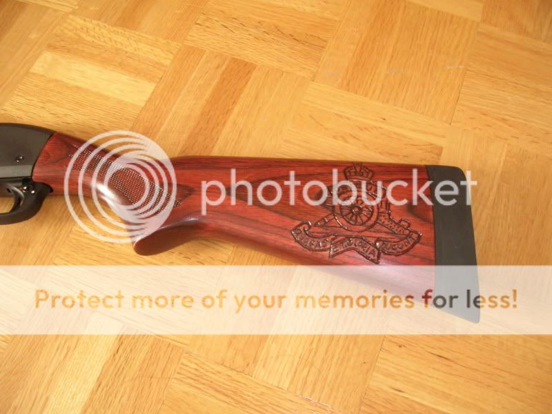

cutting down a wood stock is not too hard. just take your time and don't rush. Manbearpig gives good instructions in his post. Here is one I did earlier this year.
^mine pretty much ended up almost exactly like that, except i think i took off a bit more. exact same old style rubber recoil pad too.
did you have to angle the screw as well or did you just use a really short one?
i estimate after cutting the bottom screw would have only had about 1/4" room to go if id have kept it in its original hole.
ill post pics when i get home, i forgot to bring my camera card reader with me.
i hope you dont mind, i used your photo to illustrate what i mean by angling the screw. i dont have photoshop either so a crude MS paint drawing will have to suffice. the yellow parallel lines are the factory screws, the green is what i had to do with the bottom screw to work with the short LOP. i used a 1/8" drill bit to drill a pilot, but check your pad screws and make sure you are using a proper diameter drill bit. i recommend you do this BEFORE you grind the pad, so that any small shift in the pad when you change the bottom mounting point wont result in an ill-fitting pad.
