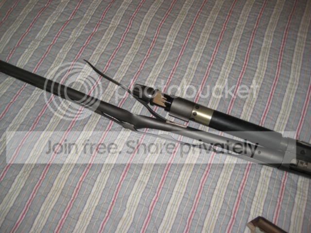

See grouse Man's pic posted of shotgun barrels in post 10 of this thread. I'd rather be a living breathing safety Sally than a dead retard.
http://www.canadiangunnutz.com/foru...-of-quot-Cut-Shells-quot?highlight=cut+shells
Edit: here is the pic. You decide if your fingers and face are worth saving a few cents over.
The results of cut shells
Whatever you say Sally.
Go inside, the sky is falling!
Strange as no where that I could find did it say those were caused by cut shells in that thread.
Yeah I know and expected someone to bring that up. That picture has been posted in numerous threads about cut shells. I couldn't find the original post. This topic comes up every few weeks. The display was created for the purpose of demonstrating what can and does happen with cut shells.
I would like to see what the original purpose of that display was for. They could have been caused by mud in the barrel, using wrong slug in wrong barrel, faulty barel or possibly from a cut shotgun shell. Or seeing as the gunsmith that had that display as stated in the thread
"The booth vendor was a gunsmith service that did new chokes on old barrels, IIRC. So over the years they got a lot of blowed-up barrels to repair."
Happened to make a few blow up to help his business?
All from cut shotgun shells? Never seen that stated.
Look I am not looking for any argument about if using cut shotgun shells was,is or will be a smart thing to do but I have never seen or heard of a shotgun blowing up in anyway from using them in my little part of the world. I have seen them blowing up from other obstructions like mud etc and high powered steel shot in an older choked shotgun.
If some or all of those barrels in that picture can be proven to be caused by cut shotgun shells then I stand to be proven wrong and will have no problem admitting to such.

The classic end of conversation "proof" for people without proof - a picture from the interwebs, followed by the classic line: "It's your face and hands!" The only thing better is a picture of an injured face or hand which are easy to find - they're on fireworks, automotive, machining and other sites, and the same pictures are happily shared, along with whatever story suits the argument.
In fact in the thread with this horrific picture it's stated:
No, I have no idea what caused them. Just food for thought.

It is pretty simple anyone still firing cut shells today have no idea what they are dealing with and it will just be a matter of time before it bites them in the ass.
I probally fired my first cut shell in the mid 60's it was very common. What we used them for was when birds would land outside the decoys rather than getting out of the blind and scare the birds off we would rip a round over them and they would lift and move on.
Did this hundreds of times until one day one of the guys blew the side out of his 1100 barrel and scared the crap out of us in the blind. We were real lucky nobody got hurt but we could not understand WTF happened since none of usr had ever had an issue like this in the past
Well what is boiled down to 99% of our successful cut shells were the old paper hulls with a gas seal and fiber felts so when it flew down the barrel it all compressed and out it went plus these where operating around 5000 psi.
Then enter the plastic hull, solid wad design. Those did not have the give and may times the plastic hull would stay in the barrel which is exactly what happened to his. When he banged off the next round the barrel was blocked from the plastic hull staying behind and BOOM plus these were running around 9000 psi.
Now enter the steel age rock hard wads and no give to the steel shot at all. Had a guy cut one of those and it removed the choke tube and split the barrel on the end not to mention is was probally 11,500 psi.
There is another 100% cut shell blow up out there also with a pic on another form which I will try to find.
Pure foolishness at this stage of the game and for what when proper ammo is available and not costly
Here is the other one that was discussed on a few forums at the time. Damage due to section of cut shell remaining behind then boom with follow up shot
