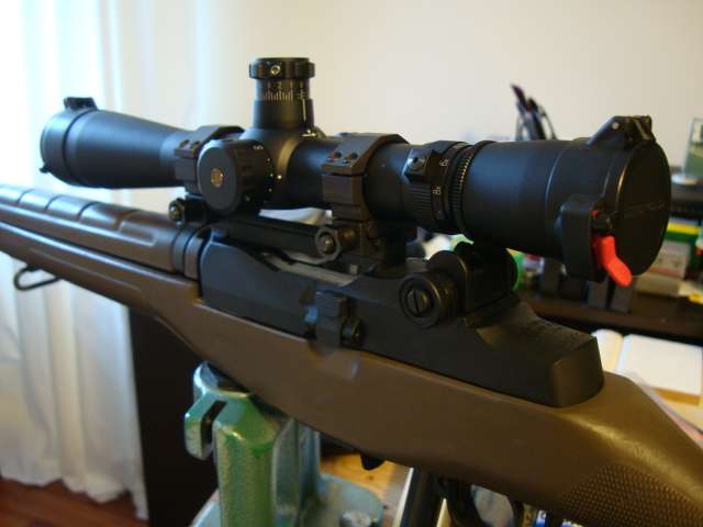

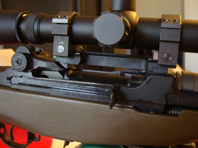

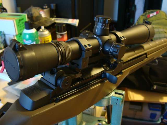

So I shot the new stick at the Service Rifle shoot last weekend and to say I was happy would be the understatement of the year. I had a s**t eating grin on my face ALL DAY!
In case you missed the specs:
Kreiger DMR Med contour barrel
TRW bolt - headspaced to 1.630 .308 match (168gr handloads only - time to kick some AR15 ass - and it did!)
TRW oprod
HR trigger group - tuned by an M14 master to 4.5lbs
USGI forged flash hider reamed to NM - rings like a churchbell on roids!
AMTU unitized gas assy - glue and screw
Rooster spring guide
Smith Enterprise bolt release
Smith Enterprise scope rings
Leupold Mark 4 3.5-10x40 TMR reticle
Got the whole works coated in KG Gun Kote to give it the appearance of a "stock rifle", the stainless barrel woulda given it away for sure. Shooting the 300meter deliberate this past weekend was a joke! I was rushing and it was scoring 5's or V's with no problem. Got super nervous when it started racking up the kills and I rushed it as there were a couple guys behind me staring :D Next year I'm goin for the perfect score - 50-10V
Couldn't help to stage a picture or two of my new favorate rifle :D

Nice to see a m14 in competition. The LRB scope mount has to be a huge benefit. I like that you went sleeper on the look as well.
Who reamed it for you BTW?
Why did you choose the screws?
YEAH buddy! I'm gonna carry that thing in Service Rifle till I'm told I can't anymore. Love being the ONLY guy shooting .308. The guys keep trying to get me to the dark side (AR's) with cheap shots and remarks about using an outdated POS but I tell them to F'off all the time LOL!
Got the flash hider reamed out by a PROFESSIONAL GUNSMITH way back when it was sorta ok to send stuff back and fourth across the border - Warbird Custom Guns. Don't bother asking him....he doesn't deal with Canadians anymore because of the border BS. Great guy tho.
I like the glue and screw method for two reasons - can't see it and its a double mechanical hold on the two parts. If the weld wasn't done properly it can crack and I've seen one first hand. If done right welding is just as good.
I really like the sneaky under the radar look of the rifle. Nothing screams "gamer" unless you know what you are looking for and know me personally ;)
I've said it before but the main reason I went with the LRB is the fact that I had an ARMS mount loosen up on me during a match. True I never checked it for years but that bothered me so I sold the parts and converted the rifle to irons only.
