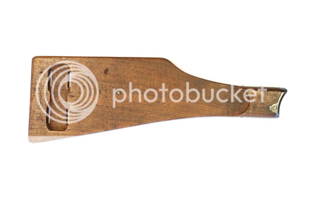

The Artillery Luger also adds a different collecting dimension with the stock, holster and other leather accessories, snail drum magazine and magazine loader.
The snail drum magazine (TM08) is not restricted as to cartridge capacity---- so it does not have to be pinned.

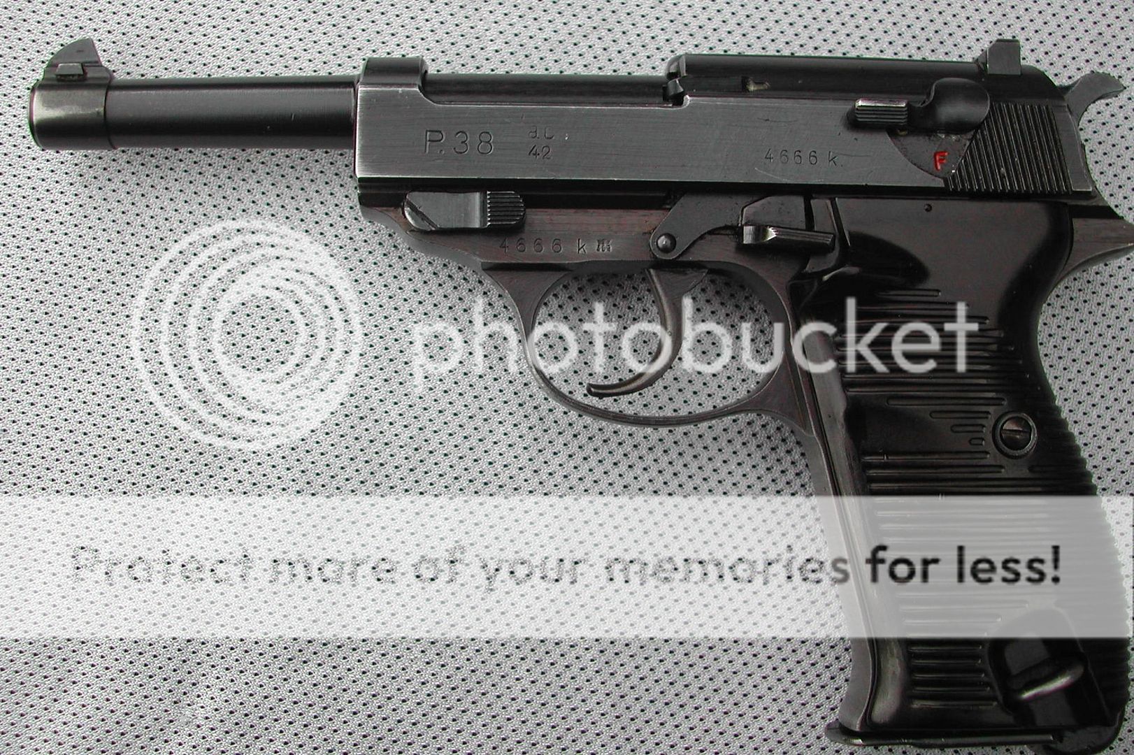

It is so much easier with the P.38 as compared to the P.08 Luger as far as the 12(6) requirement is concerned if you wanted a German WWII pistol ....as Steve suggested.
David
No 12(6) required for a WWII P.38..... more affordable in original collectable (shooting) condition.

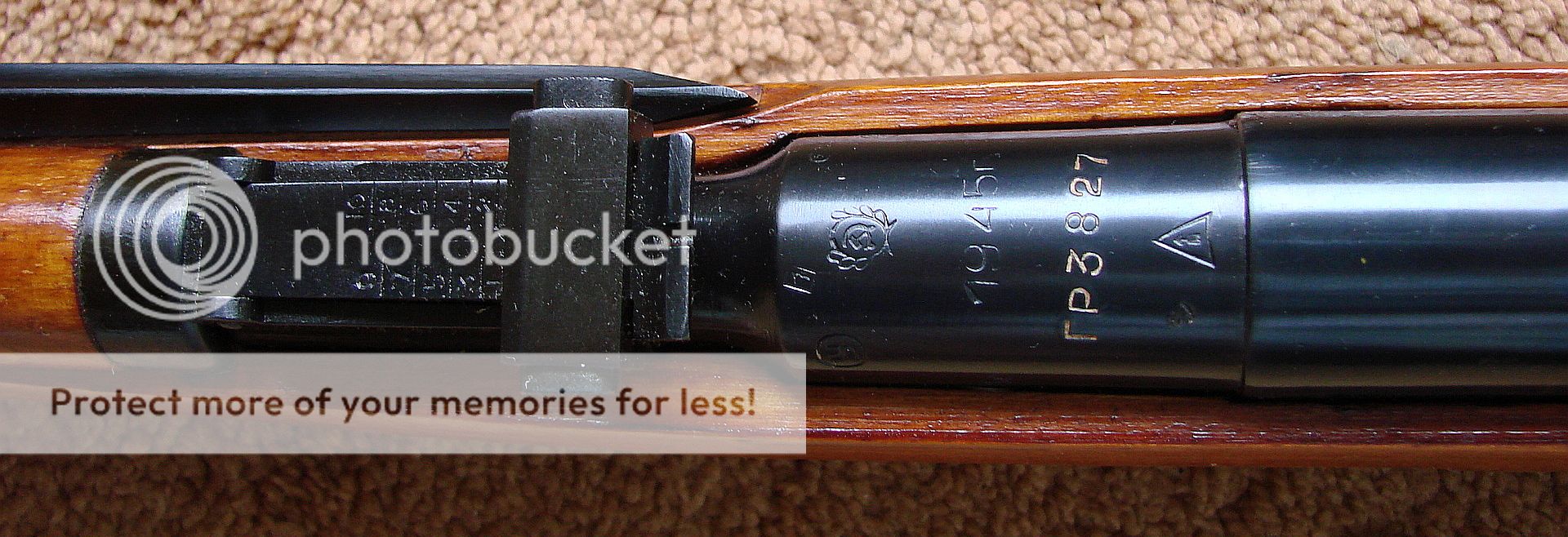

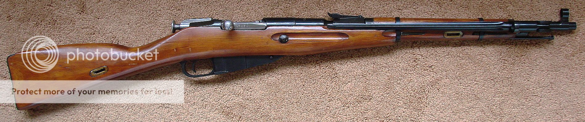

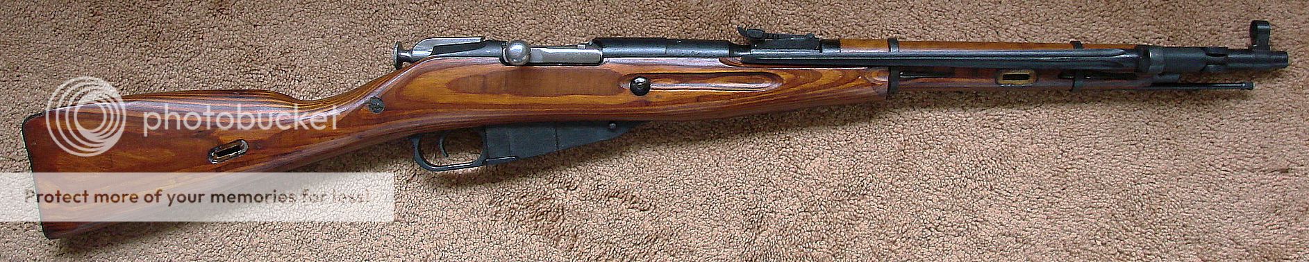

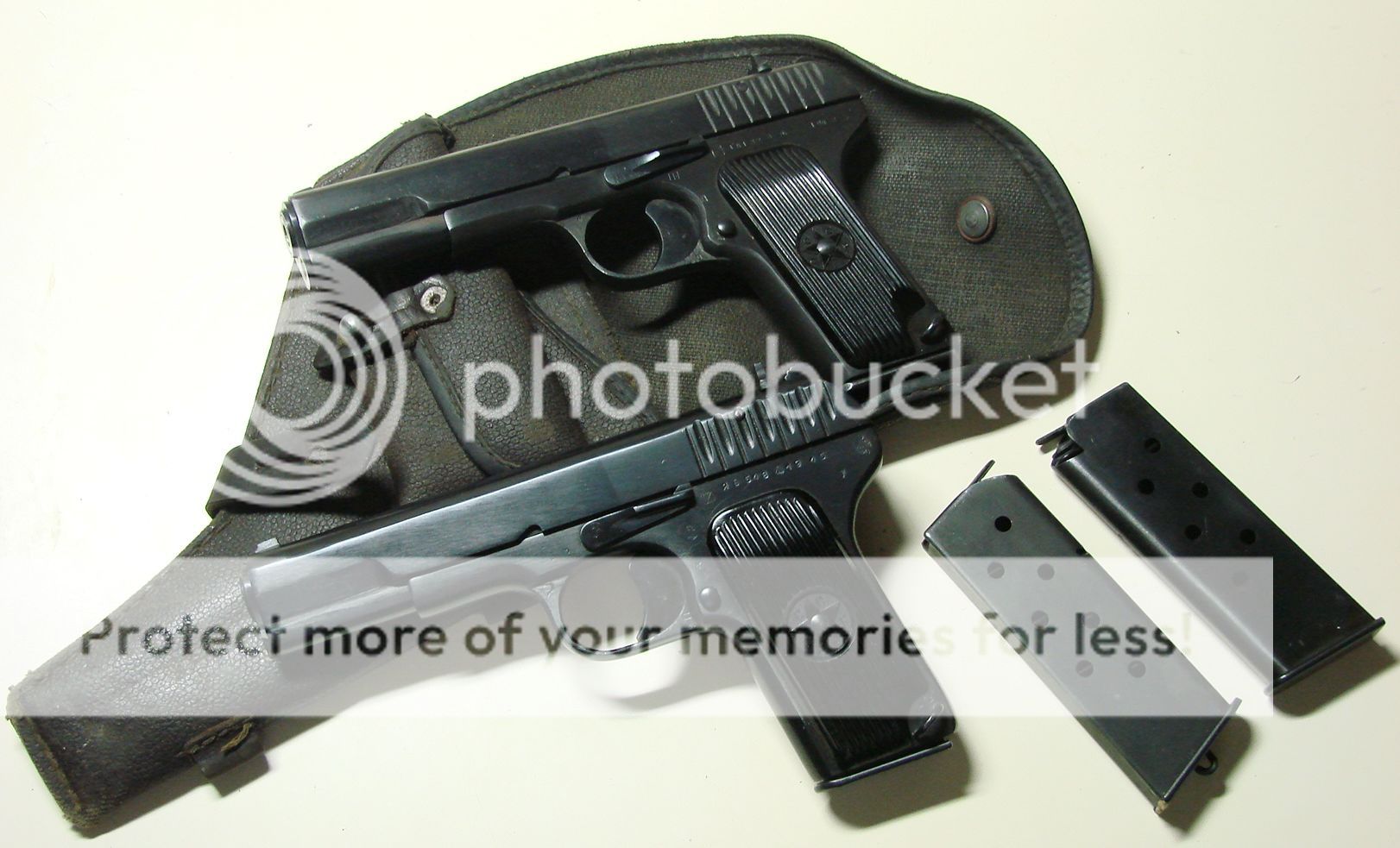

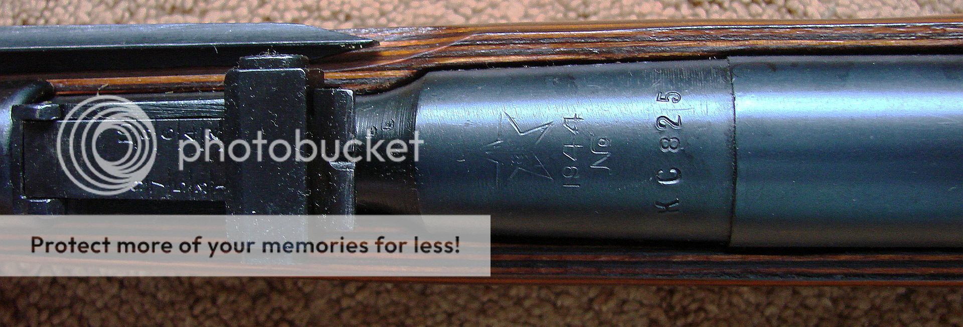

M44 Izhevsk dated 1945----Tula M44 dated 1944.
M38 Izhevsk-dated 1943.
Other purchases back in 2007. Russian TT-33 pistols dated 1942 and 1945.

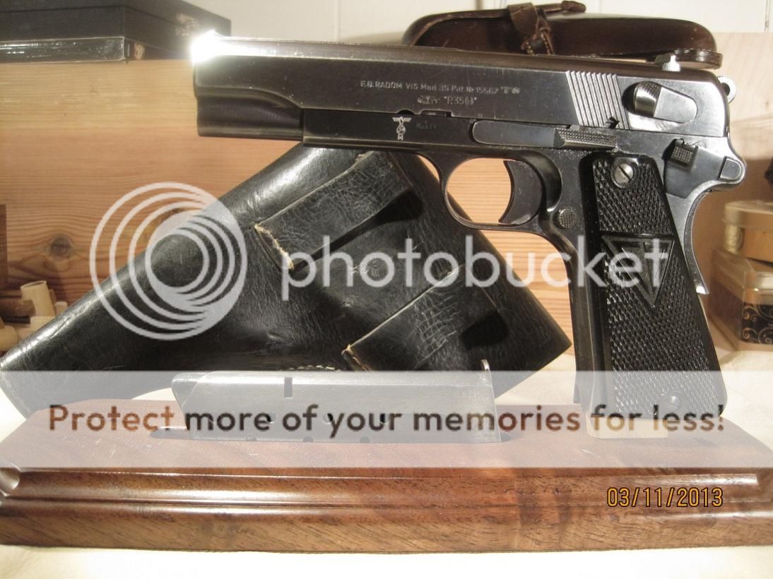

Smellie, your comment " Navies are ALL Imperial period."
This is not correct my learned friend, you will also find naval lugers in the Weimar period--newly manufactured by DWM, shortened LP08's with Imperial naval property marks,reworked LP08's sent to coastal batteries with Naval property markings and also Third Reich period Mauser manufactured P08's starting with K date, G date all the way up to 1942 when the Po8 was replaced with the P-38.
To my knowledge I have not heard or seen a naval P-38 however Star from Spain,The Radom factory,both have bonafide serial ranges for WW#2 German procured pistols that were utilized by WW#2 German Naval forces although very limited numbers.

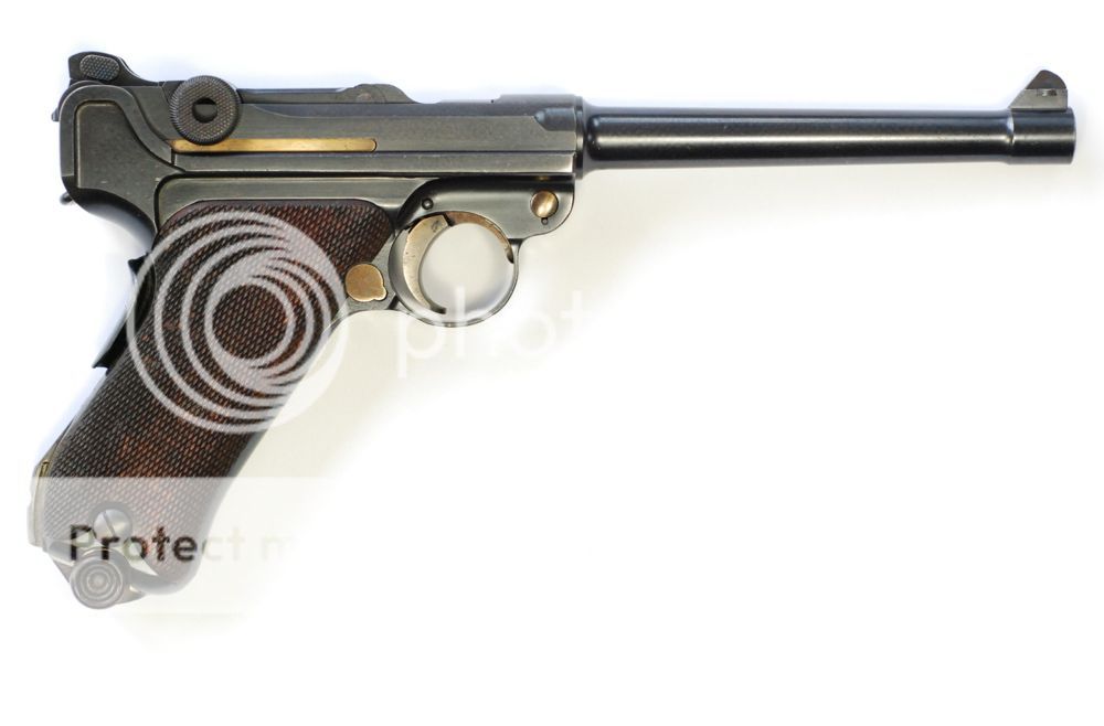

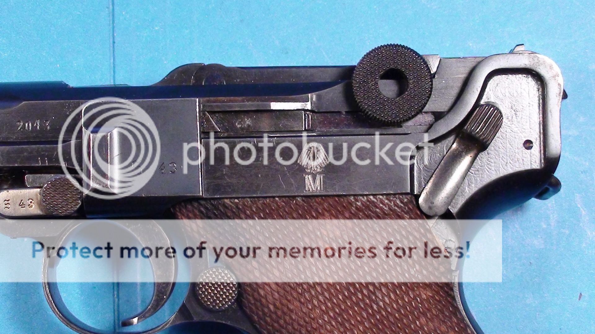

This is a 1906 Navy Luger sold by Peter at lugercollector in Canada.
This was part of a thread on Jan Still's Luger Forum following a question regarding a Navy Luger offered for sale on GB.
There are photos of a few really nice Navy Lugers and discussions about what is right and what can be wrong on these pistols.

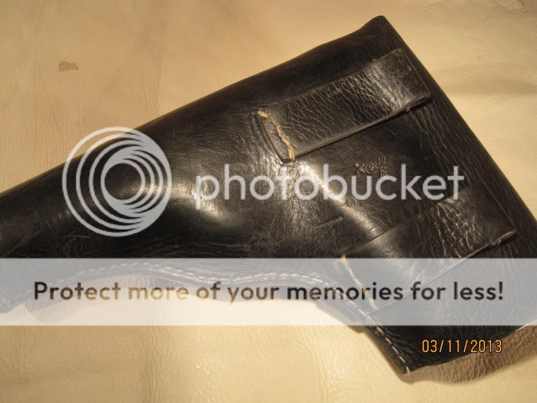

Also a discussion in another thread regarding a faked Navy Luger holster offered on GB.
Good reading for they that are interested.
Peter's pistol.
Navy 1906
Here are photos of a Navy I sold recently...it came from a 50 Year old collection..in Canada where boosting is very unusual.....no halos on the barrel sn which I believe to be correct on the Early Navy Lugers.
David

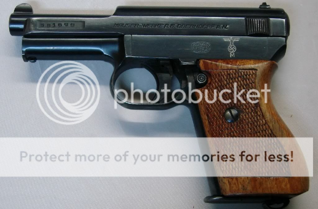

Here are photos of a recent find......as brought back from WW2 by a Canadian Veteran.
"K" date is 1934 the very first year of military production for Mauser.
Nabs,
The Navies shown above are not mine.
I would like to own one but I don't.
I have a couple of KM marked Mauser Model 1934s....thats it.
David

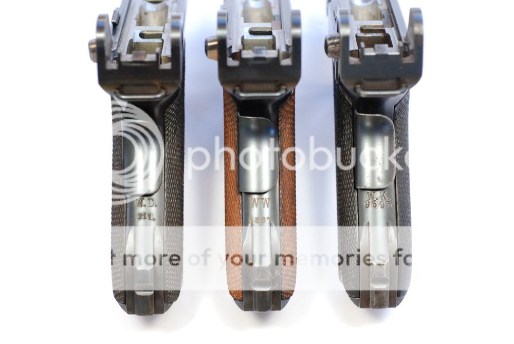

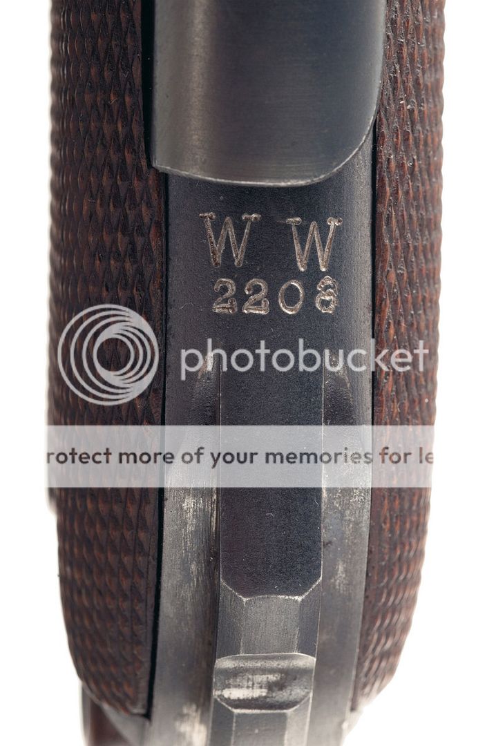

Drm3m has done an admiral job in posting pictures of an 1906 luger with long frame and an Third Reich period K date Po8--thankyou David. I simply do not have the time right now to post photos of my naval collection.
regarding the 1906 Imperial Naval luger posted by David you will note that the Lugers rear grip strap is unit marked to W.W. 1435, Werft Wilhelmshaven, primarily a dock yard weapons armament store, you will not find a Imperial naval luger marked to a specific U Boat or Capital ship, some will be marked to other docks and GOUV- Kiatschow colony. Also to torpedo units and sea batallions.

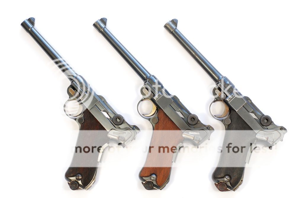

The pieces shown below belong to the same American collector and were posted on Jan Still's Luger Forum.

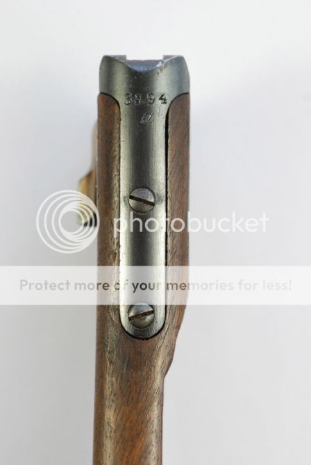

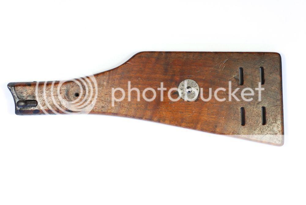

A Rare Navy Stock - A Rare Bargain
I've become resigned over the years, to having to pay through the nose for nice Imperial Navy items. They're rare, and there's lots of competition. Imagine my surprise when I chanced upon this very fine Navy stock on a dealer's website, priced so low that it had me lunging for the telephone. How low a price? Lets just say that I would happily have paid three times as much! Although serial numbered, it looks like this stock was never issued, it's correctly C/M marked on both the wood and disc, and has no "GERMANY" export mark. Enjoy the photos.
2012 Navy Acquisitions
This past year was excellent for me, a lot of great Imperial Navy stuff came my way. I was able to pick up three nice guns (by coincidence, one from each of the three Imperial Navy dockyards, Danzig, Wilhelmshaven and Kiel), a very hard to find Navy stock, a Type 1 holster with early brass zig-zag cleaning rod, a Type 2 pouch and a couple of Navy magazines.
I'd like to acknowledge the forum members from whom I was able to buy some of these Navy things: Ron Wood, Bob Young, Peter Dunster (Canada), and Kai Petter Flesjå (Norway). Thanks guys!

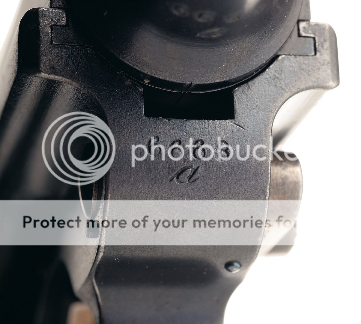

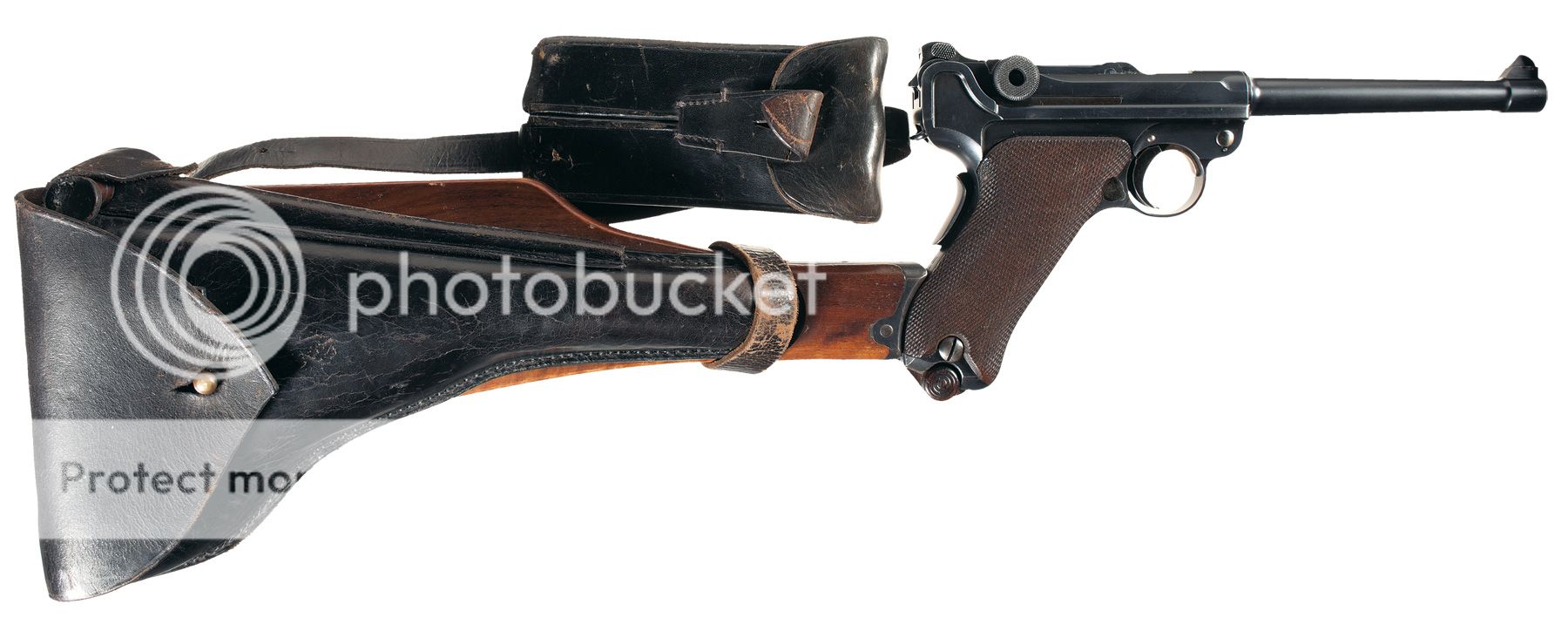

The 1906 Navy shown below belongs to another American collector. Sn 1596a. Kiel Naval Depot marking.
The pistol came with three matching magazines which is very rare.
The comment below was from a member on Jan Still's Luger Forum.
"PJ
That is a mind blowing gun! Definitely world class, and three matching magazines is almost unheard of. Your 1906 Navy Luger is a 1st Issue Altered not 2nd Issue."

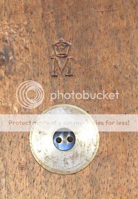

Crown over M marking on the inside of the holster....most unusual.

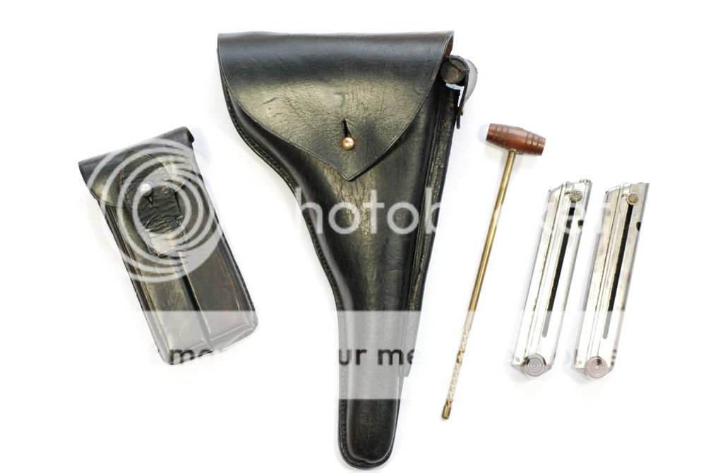

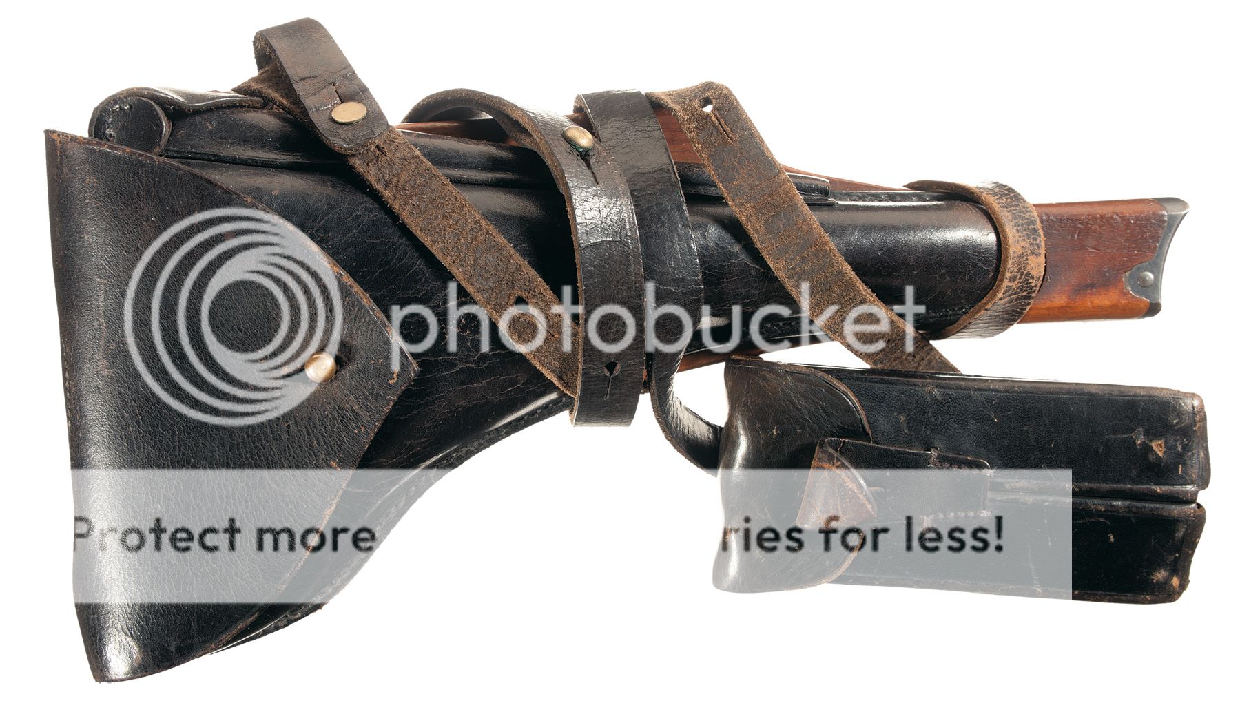

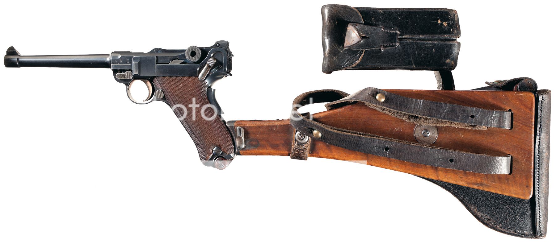

RIA Auction sale of 1906 Navy Luger rig--Sept 7 2012.
Outstanding Pre-World War I German 1906 DWM Navy Luger with Two Matching Magazines, Navy Holster, Magazine Pouch and Rare Matching Serialized Navy Board Stock.
Sept 7 2012 auction …it sold for $47,500 plus the juice.
Lot #: 3473 Estimated Price: $50,000 - $75,000
Description: This is an example of an exceptionally nice, all original DWM Model 1906 first issue/modified, German Navy Luger rig that is complete with three magazines (two matching) an original matching Navy stock and original Navy holster with straps and double magazine pouch. These were the standard pre-WWI Navy issue Lugers issued to the Imperial German Navy all the way through WWI and even into the Weimar era, albeit almost all were reworked or destroyed under the Versailles treaty after WWI. This series of Navy Luger has the standard grip safety, with the altered second pattern (upper) marked safety with no chamber date. The left side of the barrel extension has the double Crown over "M" proof marks with the smaller Imperial "Crown" firing proof, that is repeated again on the left side of the barrel. The frame and underside of the barrel are both correctly numbered with the full serial number (6668a) along with the bore markings on the barrel. The last two digits of the serial number (68) are correctly stamped on the various small parts. The back grip strap is correctly inscribed "W.W./2208". As noted the magazines that accompany this pistol are the original pre-war versions that have the nickel plated body with the wooden base that has the concentric circles on the ends. The one in the pistol is unnumbered or marked, with the two in the magazine pouch being correctly numbered length wise on the base with the full serial number (6668), along with a single Crown "M" Navy acceptance proof on each base. The two spares are contained in an original, pre-WWI dark brown leather, double pocket magazine pouch, that has a single closure tab on the front with a single brass stud, with a single horizontal loop on the back that is intended for the shoulder/carrying straps for the holster. Also accompanying this Luger is an original Navy model, walnut board shoulder stock with matching attaching iron, numbered "6668a" on top of the iron. The stock itself has a single "Crown/M" navy proof on the side and is still fitted with an original steel stock disc, that is marked on the disc, "W.W./2208". The pouch is marked on the back, "H. MILLER & Co./Offenback a.M.". The holster itself is an original German Navy model that accommodates the six-inch barrel and is marked on the inside "LOW SOHNE/ACT./GES./BERLIN". It has the correct cleaning rod pouch sewn on the side, with the pouch for the take-down tool on the inside of the flap, that contains an original Navy proofed take-down tool. The holster is complete with an original wooden handled, brass cleaning rod with the zigzag end.
Condition: Excellent with 95% plus of the original blue finish overall with slight wear on the edges and high spots overall with some blue loss on the front frame rails, the side plate hump and the left side of the muzzle area. The grips are also in excellent condition with nice sharp original checkering on both sides with light wear across the tops of the checkering. The stock is in very fine condition with a nice even original brown color overall with nice clear sharp markings and proofs, with normal handling marks and light scratches on both sides. The holster, magazine pouch and straps are all in very good to excellent condition with nice color overall, clear distinct markings with nice tight stitching with normal scuffs and light age cracking in some areas. As noted this Luger rig has matching numbers except the one magazine as noted, the firing pin which is unnumbered and the right grip panel which is also unnumbered but correct. An extremely rare example of a very scarce and complete 1906 Navy Luger rig.
