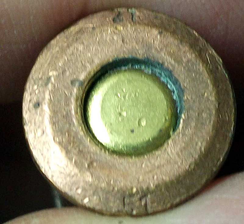

1951 Hungarian Surplus
Advertized at Milarm in 2003 as Hungarian 174gr Heavy Ball
Yellow Tipped
Cases marked
21 (I believe this is the Country of manufacture)
51 (Year of production)
This stuff was being sold around 2003 through Milarm

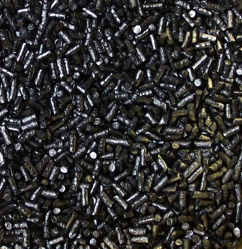

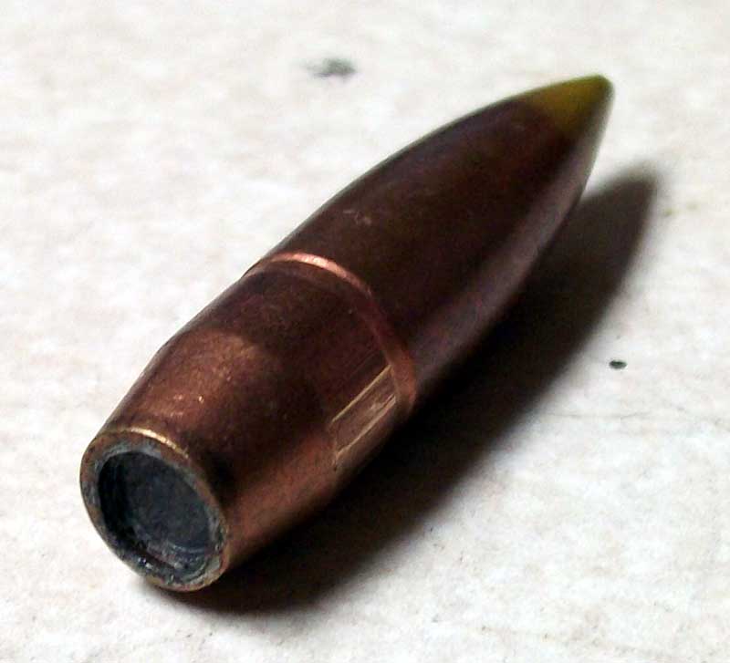

My measurements of a limited sample indicates:
183.6gr FMJBT - .3105" diameter
47.4gr of an extruded powder
According to 7.62X54R.net this stuff is moving at 2710 fps +/- 24 fps. That's pretty fast - almost .30-06 territory. Lots of split necks and sticky bolts when trying to extract. A bit hot IMHO. I think 2550 fps sounds a bit more reasonable to me.
So much for Milarm's attention to detail H:S:
I just discovered that this powder pic makes for a great desktop back ground too :)
